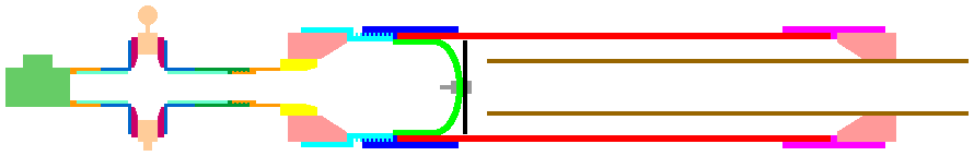

umm i see kind of. haha seems like a lot of work. i don't have access to a lot of metal supplies during the summer tho.. I was thinking about hooking up a drill to the male end.. or maybe fashioning a large wrench that fits around it. hmm any ideas on how i would go by fashioning a drill to it? I made a rough sketch of the gun, without any mods for quick loading:
- I'm wondering if i should use two 90s to move the sprinkler valve and fill area on top of the gun...

also, how would i go about centering the barrel in a 10' long chamber?

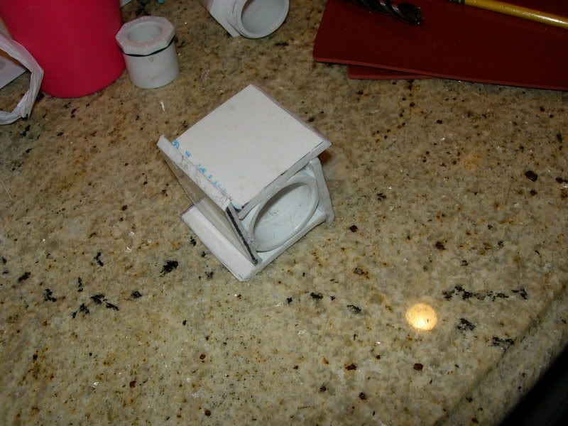

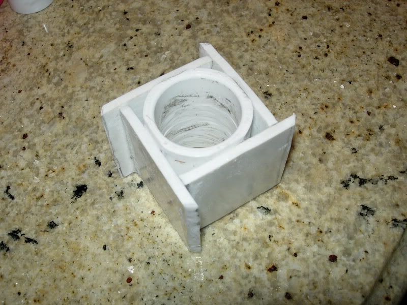

about the barrel centering, i ran into the same problem with a big 3" camber 1" barrel 5 foot long coaxil i built a while back i used this thing...
<img src="http://i78.photobucket.com/albums/j85/i ... CN2261.jpg">
<img src="http://i78.photobucket.com/albums/j85/i ... CN2263.jpg">
basically its a 1 inch coupler i bored out so it could slide it over the barrel, then i ca glues some flattened PVC sheets to it, and cut them down to size using a dremel. the PVC was flattened by cutting a piece of pipe in half, then sticking it in boiling water, then quickly pulling it from the water and flattening it between two pieces of wood. it takes a few trys to get right but its not that much work once you have the water boiling
