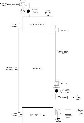

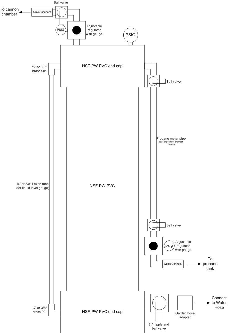

I was bored, so I did a quick Visio sketch of my idea for a gen2 tank. The Lexan tube for the liquid level gauge (just lets you see how much water is in the tank) is optional but would be very convenient and shouldn't cost much extra. The regulators, technically, are optional (you'd need a PSI gauge on the meter pipe at least) but again would make things much more convenient.
This design could be constructed in a variety of sizes to fit different sized cannons.

Thank you pete, that plastic tube idea is genius. I was planning on mounting it horizontally (like DR) but I will mount it along the vertical support of my stand. It'll be a lot cleaner looking.

No prob.
I technically took the fuel level gauge idea from PyroDude's flamethrower design, but I've seen it used on other things before that, like the storage tank on my water well.
I was going to add, I personally (being a paranoid safety freak) would put a 1" union with a pop-bottle burst disk at the top, just in case of the very unlikely situation of over-pressurization due to combustion. But it's not really necessary. Just make sure to pressure test it for leaks before use....

Allready had that in mind, but on the bottom. Then it will double as a water drainer.Pete Zaria wrote:No prob.
