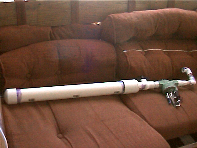

hi I have a 2inch by 24 inch chamber and a 1/2inch barrel. my sprinkler valve honks when i try to pump up the chamber so i bought a ball valve to go before the sprinkler valve. when i open the ball valve air comes out the end of the barrel. Has anyone else had this problem?
i tried everything from 10 psi to 60
how can i clean it out? just rinse it with water?

Check for any peices of plastic that mite have gotten into the diaghram or try lubeing it up really good.

i found out that the blow gun wasn't sealed very good and air was leaking around it
. should I put epoxy around the blowgun
and what should I lube the valve with? should I use wd40 or soap?

Epoxy the leak, or just screw the blowgun in tighter with more teflon tape (you did use teflon, right?)
Lubing the valve really isn't necessary. My valve has worked fine without it for two years now. However, you may still want to open up the valve from time to time to check for debris that may be clogging it.

P.S. If that solenoid is bugging you, you can take it off and epoxy its hole.

dont use wd40 or soap for lube 4d40 will melt the valve eventually. Vaseline should work good

Where's your fill valve? Is it on the chamber-side or pilot-side of the sprinkler?
Check for more leaks with soapy water and etc.. til you're pretty sure you have them all sealed up. Let us know how it goes.

FYI, Vaseline is petroleum-based, too. Lithium grease, Teflon-based lubricant (try bicycle stores), etc... is the best choice for lubricating rubber seals.

i put epoxy around the blowgun but it is still leaking around it. i put another layer of sealant on there and i am waiting for it to dry. i'll post more pics when I fix it.
i tried eveything I could think of to seal the blow gun. I finally got the adapter sealed and now it leaks where the adapter screws into the blowgun.
