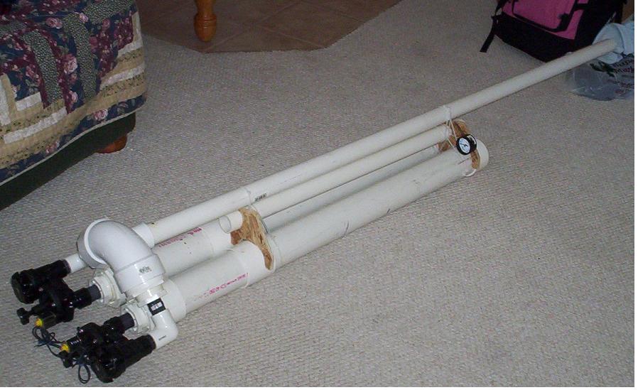

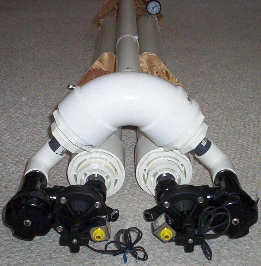

i was wondering when reassebling the sprinkler valves should i leave in the springs or remove them? i dont see what good they would do besides closing the valve when the pressure is low enought that the springs decompress. would you even notice the loss of this small amout of pressure? also should i try and go through the pain of removing the twist adjusters on the main plate of the valve or just leave them? i was just gonna leave them but i wasnt sure.
nick
the gun is a dual 3" chamber with dual 1" valves empting into a 1.5" barrel. any other question about the gun welcomed. it is my second cannon and i am pretty anixious about firing it. i get to bring it into physics to show off gotta love small schools.
modding sprinkler vlaves.
Leave the springs in. When you mod the valves you can connect both hoses into one blowgun (you might already know that). You can leave the "twist adjusters". Nice gun! Perhaps a side view of the cannon? When you finish defintly post some damage pics and tell us how it works. If I brang that to physics I would get arrested! How did you connect the barrel to that 90 elbow? Was there already a factory outlet there or did you tap the barrel into the side of the elbow? Looks nice besides the fact that its a MONSTER!
yea i was gonna hook both of the hoses into one release valve of some sort. the town i live in doesnt really have a good hardware store. we have an ace but its pretty small a nd does offer what i want so it might take another week or so to get all the fittings and hose. the elbow does have a factor outlet in it. my physics teacher is in love with these things. for the first week of school we just shot off spudguns then calculated hot high fast and all that. pretty fun. i will upload some other pics of this gun.

one more question i was looking aroudn the internet and i can't seem to find like 4 or 5 feet of pressure hose 200 psi+ is it possible to buy pressure hose without gettin 25 or 50 feet of it since i only need 4 or 5 feet.

You should be able to buy air compressor hose at ace by the foot. How high of PSI do you plan putting in? Im guessing but when you said "i can't seem to find like 4 or 5 feet of pressure hose 200 psi+" are you expecting to reach pressures of 200 PSI? If I were you I wouldnt go any higher than 120 PSI because you risk having parts on your gun fail.

yea i wouldnt think of going over 120 i start to get nervious at 90.but yea just for a buffer zone i would like 200 psi. the ace here doesnt sell by the foot. but they do have some stuff like 10 feet for 5 dollras so i think i will go with that. sorry bout the triple post i didnt relieze there was a edit button. but yea it should be firing by friday so i will update when i can.
