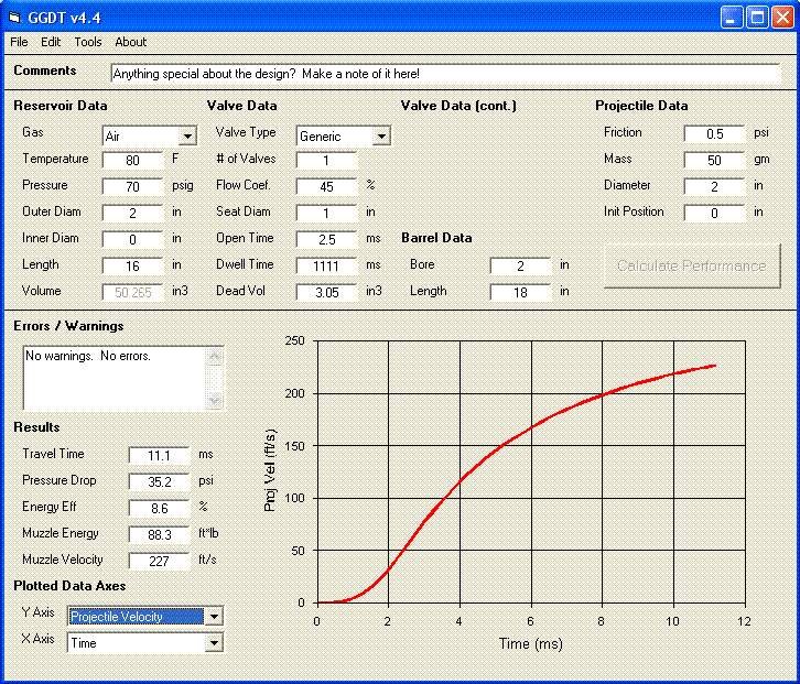

Well, from my ggdt results, you're not going to get much better than 230 fps with an 18ing barrel at 70 psi.
Also what is your projectile weight? I just used 50 grams.
Are you going to be using co2? it would be a lot more stealthy than a compressor.

That should be ok. I will fiddle around a little with the ggdt now that I have the values for the valve and such. Never figured those out before.
You left inner diameter of reservoir as 0 in your ggdt.
um, a quick question, what should I put as dead volume for the valve?
