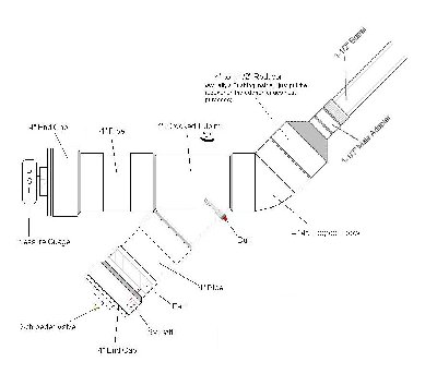

Basic combustion design.. Looks okay?
bigotry2
Posts: 22
Joined: Mon Jul 02, 2007 4:36 pm
I bought some wrong PVC pipes when I was looking to build a pneumatic, too lazy to return them, so just making it into a semi-hybrid cannon. It's not set up to pressurize the propane, just the air, so at least I'll know it will shoot.
My purpose is just to have a very clean looking gun, with no dry wall screw for ignitor (I've already got it attatched into my T-joint thingy) it's just drilled straight into the pipe, sealed with epoxy putti and J-B Weld. The reason for the 45 degree elbow is ease of firing angled shots and I just though it looks hella cool. 8) Possibly considering putting a switch on the outside for the fan.. Possibly. The reason why I put it on the bottom extrusion is because propane sinks, thus the fan will blow the propane towards the sparker. :lol:
Any nice suggestions for making it look clean / sheek / awesome? :idea:

That's a weird looking chamber... for combustion a plain cylinder would probably be best, but for pneumatic only I don't think the shape will affect flow that much. I'm not clear on how you are getting propane into the chamber. You should have the 9V battery outside of the chamber and you should use a switch of some sort.
4" pipe fittings are rarely pressure rated, If you don't have pressure rated PVC fittings you should reconsider you building materials. Non pressure ABS is ok because it won't shrapnel, but non pressure PVC is the worst of both worlds.
You need to be very careful if you plan on using this with any sort of hybrid mix. Remote detonation seems necessary, your asking for it with a shoulder fired PVC hybrid especially since the large diameter pipes are rated at low pressures.

um, if you said that your using propane, where is the meter?
Ah I wouldn't use that for a hybrid or a pneumatic if you feel like living anytime soon. Thats a wye used for a chamber. They are not pressure rated, they are DWV and very thin. Do not use it as a chamber. Your whole chamber is DWV.

Well like I said they were left over pieces.
How to get propane in? Simple. Unscrew the cap and just stick the torch inside. :lol: Its extremely crude but thats how I've done it for a long time.
9V Battery on the inside to clean it up (like I said). Like I also said, thinking about a switch. If there will be no switch then what it will be is a 9V Battery holder with the clip on wire thingy where you just snap it to the top of the battery.
You are correct, these pipes are not pressure rated. Remember these are left over so these are going to be the ones I'm using. I won't be pumping the PSI very high at all (15 - 20 tops), which is why I put it in the combustion section and not hybrid section.
I will remote detonate it the first few times to make sure its safe. It's not shoulder fired, its hip fired, I'd NEVER hold somethign like this near my face when its ready to shoot. :lol:

His pipes may be pressure rated, but it isn't going to make a difference with the DWV fittings. You could possibly return/exchanges any parts you haven't glued or drilled so far and buy pressure rated stuff or ABS. Still if you are going to use this as a shoulder fired cannon, I wouldn't even recommend ABS. The best fittings have NSF-pw written on them somewhere.

well, if you use DWV, your just making a wierd looking pipe bomb, so i would not build the rest of it, unless you can paint it really cool and show off the paint job and never fire it.

The problem with this is that you are using unrated PVC. If it explodes you could be seriously hurt. ABS cannons are unrecommended, but will not kill you if they explode, just burn you a little.
