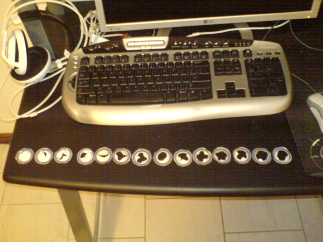

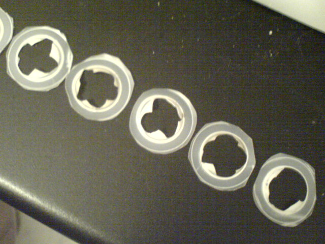

hey scotty and others (yes scotty im east coast, sydney. Kit was around 40-50AU incl postage) , ive spent a few hours firing the beast today, unfortunately my camera phone has been on charge all day and my firing setup is underneath my house (insulates the noise). After i scrambled up through the spiders and dirt i really didnt feel liek getting back in there (plus its fairly dark, even with the mini shooting range / lights setup i made). i did however retrieve some burst disks and photographed them. the day was spent firing a few 4x shots for warmups, then 5x, then i mainly did 6x shots all day, with three 7x shots to finish the day off. The gun performed suprisinlgy well for such a tiny chamber (chamber is 180mm deep, wall thickness of 11mm, rear wall is 20mm thick, I.D of approx 31mm). I used a few different barrels:10MM I.D. aluminium tube x 1.5m (loose fit for 3/8 steel balls); 1.5m approx glass marble claibre barrel (ghetto setup, temporary for the day - will be replacing with a 2m version and setup better); in 20mm (3/4") pressure pipe i have two barrels, an 80cm, and a 200cm; in 25mm (1") i also have two barrels of 80cm and 200cm. The gun failed to run witht he 2m long barrles with a 4x, but 5x and over the barrels ran beauifully (in both 1inch and 3/4inch calibres). i own a shooting chrony also, but dont have a setup for dark areas (ill make one soon), ill be recording some speeds soonish. ive made many glass marble pneumatics and am quite familiar with the penetration of the marbles, so my guess for the 1.5m barrel @ 6x is about 550-600fps, judging by the penetration. my targets where layers of 1/2" MDF and 5/8" chipboard. To me the marble calibre seemed ot restrict flow alot, showing pretty limited power imo; im going to attempt to solve this with a better 2m barrel setup and a straight barrel (barrel wasnt straight) and try a bit higher mixture - i woudl like to get around 850fps with these marble barrels. Its obvious that the 20mm and 25mm barrels are getting higher speeds (ammo is wodden dowels). Overall im happy with the guns performance, my original ambition of supersonic marbles may be unreachable, though. I defianately want to go supersonic with this chamber though, just need to play with some ammo ideas - im conifdent the 20mm calibre will deliver such results. The burst discs i am using are perfect, and only costing me 5cents a shot, they are the bottoms cut out of diposable plastic cups, i bought 100 for $5AU And they work beautifully for 4x -> 7x (havent tested 8x +). Most of the center of the disc breaks into pieces and fly out the barrel (occurs 5x +), the pieces are small and dont obstruct flow. The gu is only in an operational state, and will sport many improvements soon, incl a 0-1150psi gauge to record peak pressure (need to get a check valve), a Timber housing which will hide all gas lines / electronics (apart from remote trigger). Thought id give out a few observations and info on my testing for all to enjoy. Ive been a member on spudtech for about 3 years, this seems to be the new spudtech>>?? just wondering what happened to it?? - cheers, josh.
