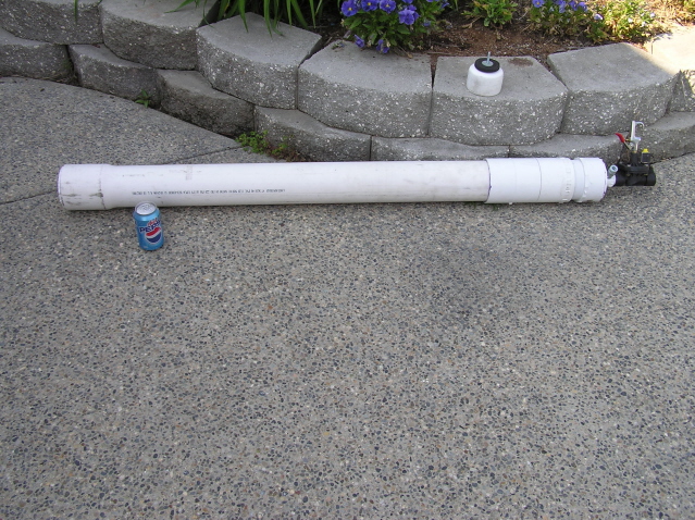

Here is a picture of mine...

frankrede wrote:Great googlay mooglay!
Thats a beast!
