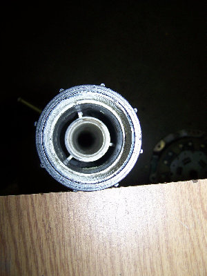

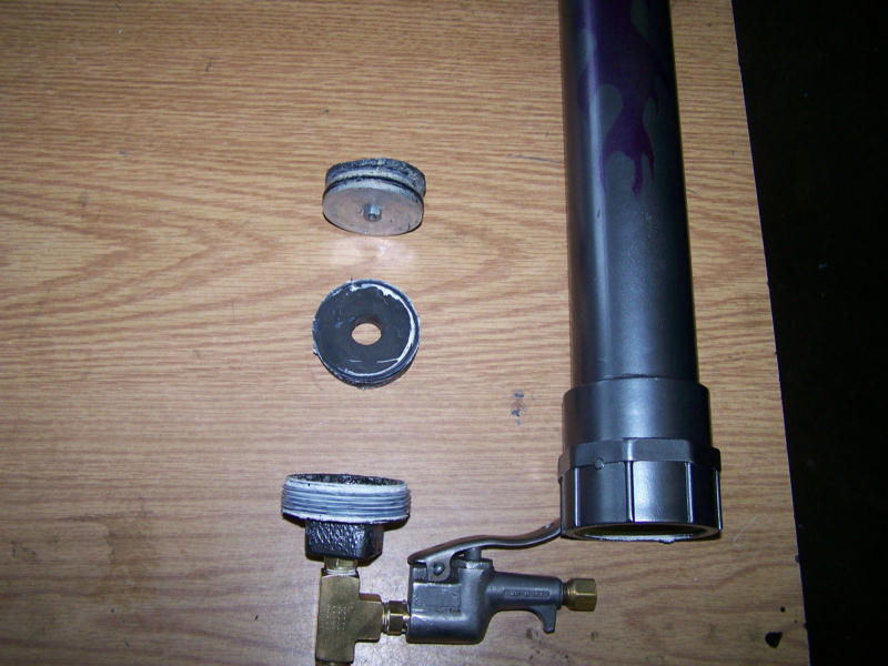

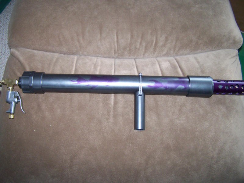

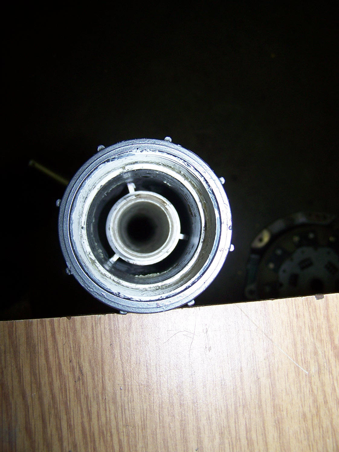

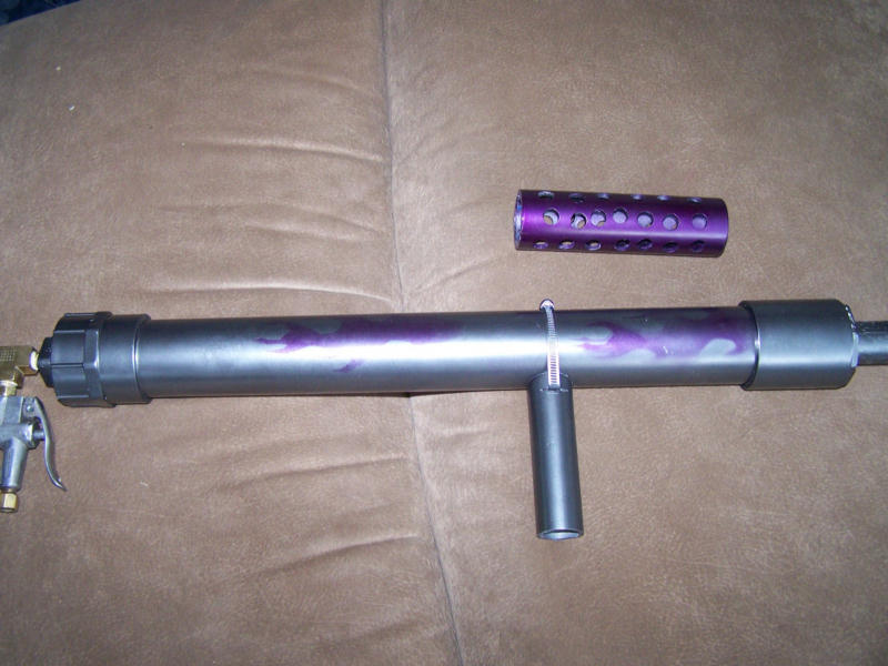

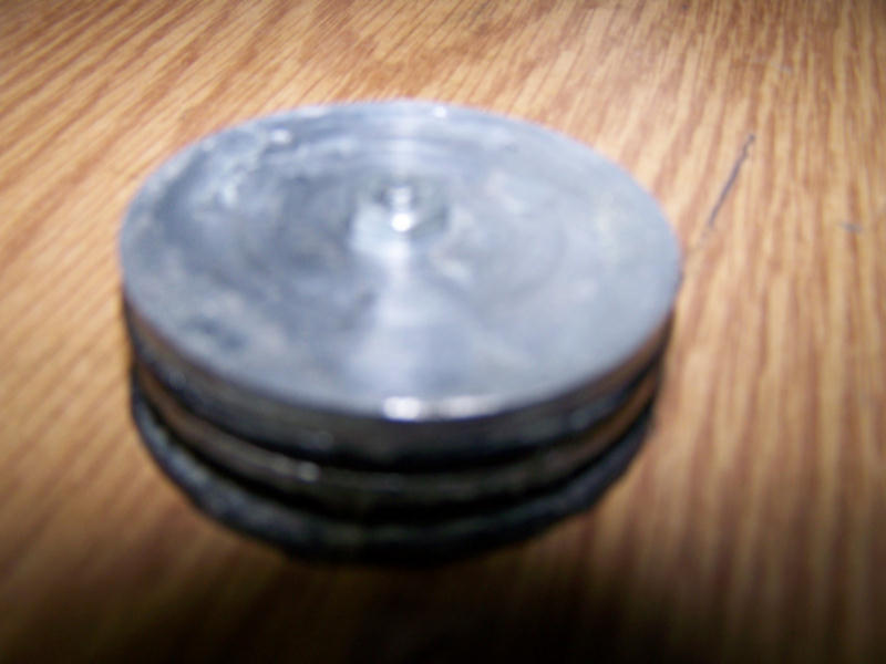

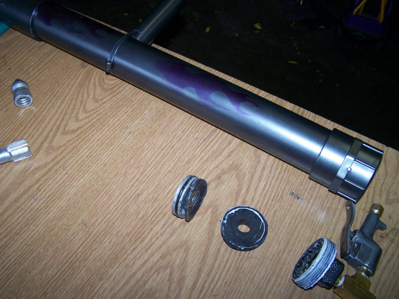

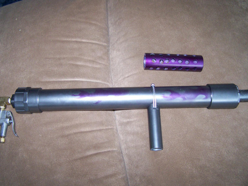

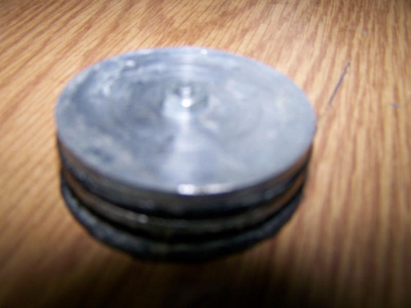

Well this is my first coaxial it is 2" chamber and a 1"barrel.The piston is two inch round aluminium with a o-ring groove.I only have these two pics on this computer and i forgot my camera cable so i will update the pics asap.Here are the internals.

Really cool gun, but the handle destroys the great look.
If you want better aesthetics, get rid of it or make it a lot better.
Oh, and the cleanout cap in the back of the gun isn't pressure rated. Find a threaded plug that says NSF-pw on it.
