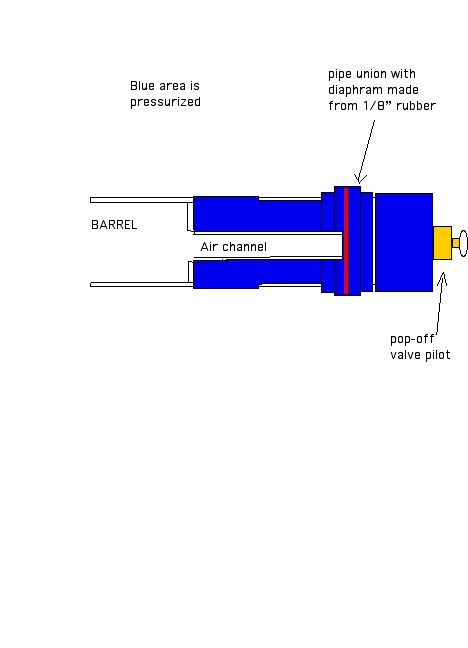

If you want to make a small launcher to mount under your airsoft gun, I suggest making a small diaphram coaxial made like this:
- grenadecoax.JPG (17.73 KiB) Viewed 3886 times

a coaxial means the barrel is within the chamber kinda like layout of the wire in a coaxial cable(tv cable). for you your best option would probably be a barrel sealing tee similar to the diagram MrCrowley drew. all you would need to do is put a female 1" threaded adapter on the barrel to screw in your "grenades" and drill an extra hole in the back for the schrader valve. if you need me to i can draw you a diagram

yes it does...its a basic pneumatic.. he pressurizes it with the tire valve, screws on an adition to the ball valve like pre loaded shells with cotton as sabots and paintballs in the middle...SwiftFix, your "diagram" makes no sense at all.
Actually sdudthug was right about the basic pneumatic. I made a couple of these but the ball valve in the middle was really hard to turn while holding the gun up. I was planning to use airosft bbs instead. I've done this many times with larger models but someone suggested a piston valve but I didn't know a thing about them so I came here
I was looking at the diagram but the specs are way to big to fit on the foregrip of my M16. There's no way I could fit half a tennis ball in there.
A diagram would be nice
