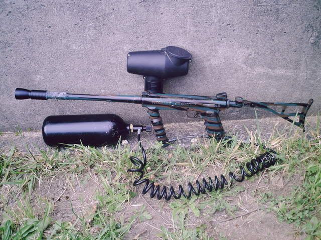

The Tippmann one is a regulator. It has a duel output, one regulated and one unregulated. The unregulated one can be plugged with an 1/8" galvanized, female pipe plug. This regulator is adjustable between 0-800 psi. I currently run mine at 100psi.NoXi wrote:the tippmann one is not a regulator. It is an asa.
K.I.S.S. "Keep It Simple ******"
I have not added the gauge yet. Here is a picture (this picture is just before I added the regulator):PinHead wrote:Very nice, I assume that means you're using that same one? Did you add a guage with your as well? What kind of gun are you using it on?
Tippmann 98 Custom with a few mods.
I will be adding a ball valve as well as the gauge later on.
