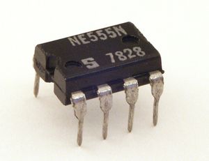

NE555 from Signetics in dual-in-line package
