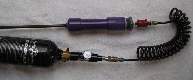

Use as a Dye/Paint
The unsightly stains caused by purple colored primer can be made to look less noticeable by covering the rest of the PVC pipe/fitting with primer also. Multiple coats may be necessary to achieve the desired shade. This dyeing method is especially resistant to scratching and was used in this .25 caliber piston valve cannon made by BillyBobJoe of the Spudtech forum.
It should be noted that this rifle suffered a fracture in the rear female adapter, which was most likely caused by an overtightened SCH. 80 plug. The primer only penetrates the surface of the pipe/fitting and once it has had time to dry and dissipate, overall strength of the finished product should not be compromised.
