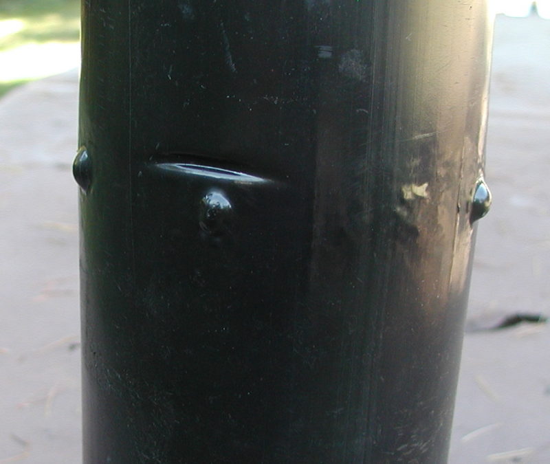

It liquefies at slightly above boiling water. I don't know how long it will stay liquid or if it is chemically breaking down at that point.
I heated some ABS DWV Cellular Core pipe over a flame to see if I could bend it like PVC. No such luck, the inside remained stiff when the outside started to liquefy. The trapped gas in the cell core expanded and blew bubbles through the outer jacket as it started to melt. When bubbles appeared, I stopped heating. The bending test was over. I'll do another test later in an oven to see if it goes fluid or just like taffy. I didn't heat it enough to drip. It may behave like melted HDPE and be squishable like the inside of a grilled cheese sandwich.
I'll grab a photo of the bubble pocked pipe and post it here later.
Update: Photo is in a later post

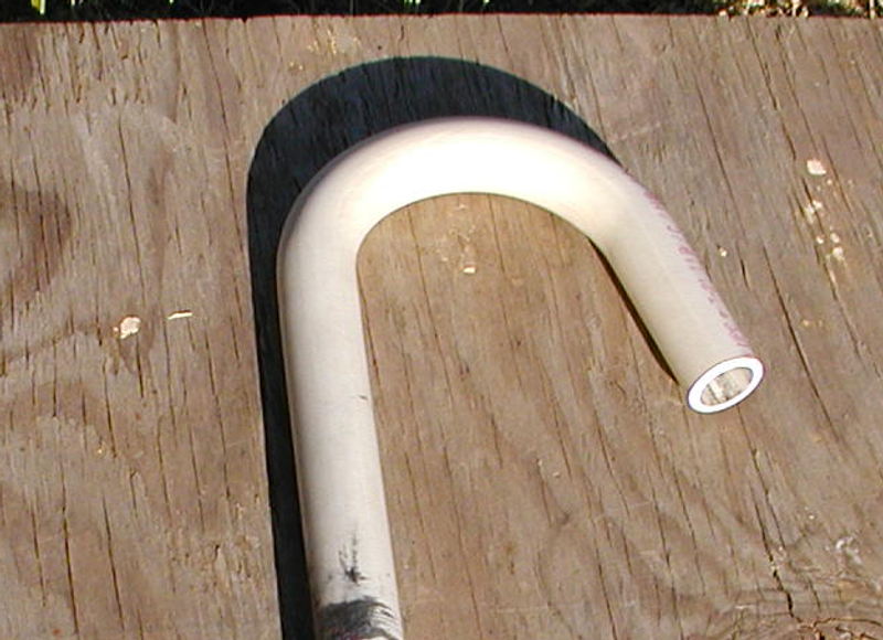

As promised, here is the photo of the test of heating ABS Cellular Core DWV pipe to bend it. It was gently heated to soften it over a torch by rotating it to evenly heat it all the way around the same way I bend PVC. The ABS started to become shiny (glossy) as it started to soften, and then as it softened to the core, it blew bubbles. An attempt to bend or dent it by pushing on the edge of a propane tank handle only dented it, but did not bend it. The bend test was a complete failure. This is a piece of 3 inch pipe.
A comparison photo of the results from an earlier PVC test is included.
There is an excellent possibility it may be able to be melted to cast the stuff as a stronger replacement for hot melt glue stick pistons.
