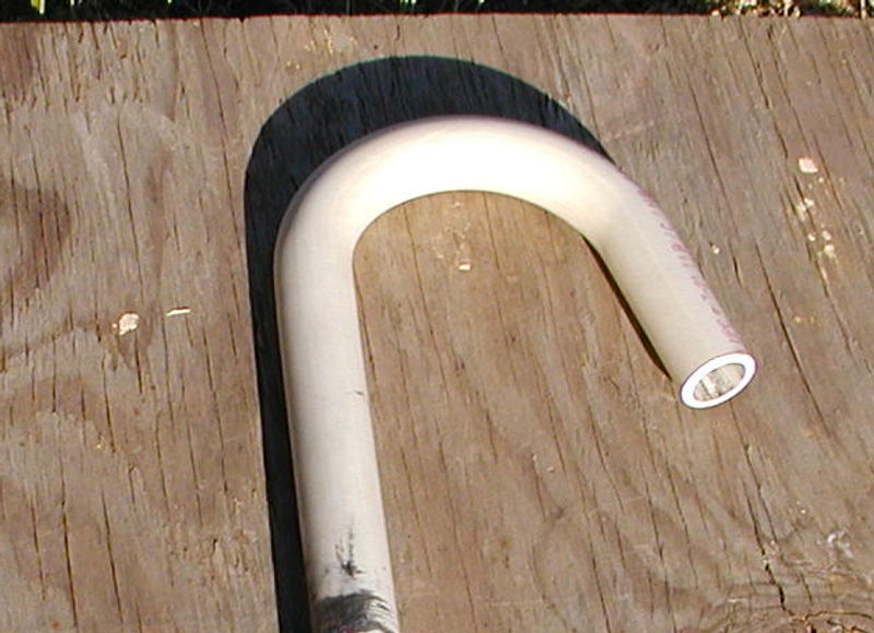

The washer was made with a hole saw. PVC pipe was heated and pressed flat first.

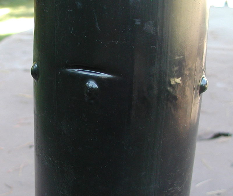

I melted some ABS over the weekend. It may be possible to cast the stuff. That could be a fantastic piston. More testing is needed.

Whats the tempature needed to liquify ABS, how long does it stay liquid, I can see it being used for pistons, vortex blocks, ammo, and asthetics.
