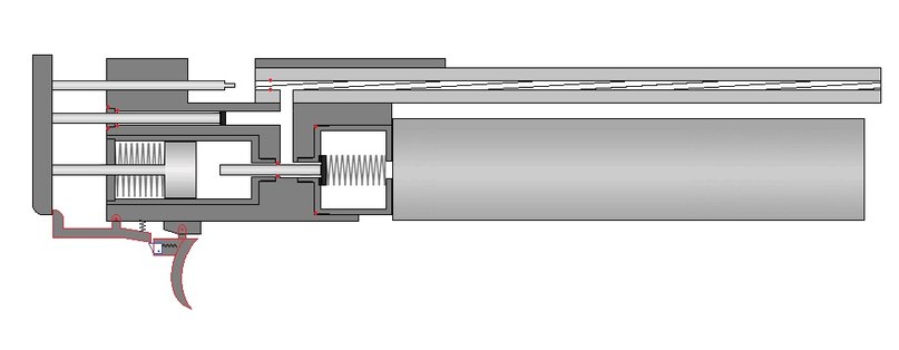

I wonder how a Caselman-style blowback would work with a balanced hammer valve, with a much weaker spring needed to knock the valve open you could presumably achieve a repeating cycle with much less pressure than the 3000 psi recommended for the original.
Thu Feb 28, 2019 9:23 am
Above concept drawn to scale with a Crosman 2240 type grip and trigger group, and a 13ci HPA bottle (click to embiggen)

jackssmirkingrevenge wrote:I wonder how a Caselman-style blowback would work with a balanced hammer valve, with a much weaker spring needed to knock the valve open you could presumably achieve a repeating cycle with much less pressure than the 3000 psi recommended for the original.
Does the blocking element of the bb`s have a spring? or is it with an air chamber?
Thu Feb 28, 2019 12:00 pm
hectmarr wrote:Does the blocking element of the bb`s have a spring? or is it with an air chamber?
Yes there's a spring, you can see it in the last drawing I posted.
Edit: build started, turns out my Crosman grip dimensions were a bit off on the original drawing so here it is redone to more accurate scale:
