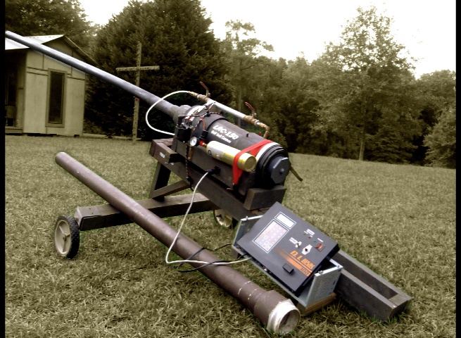

So this is really old but Mark.F. and I finally got a more accurate measurement of the muzzle velocity (originally estimated at 580 fps). Mark.F. built a basic chronograph and we did several shots at different pressures and got a consistent reading of 830 fps. In a vacuum, it will go about four miles, provided it travels in a straight arc at 45 degrees. Factor in air resistance and junk, I think it is safe to say it will achieve a half mile.

Using both GGDT's built-in range calculator and a quadratic air drag model with a generous drag coefficient (in excel using a 10ms time step) I get a range of about 1000 to 1300 feet (under 400 meters or 1/4 mile). Still pretty respectable.
