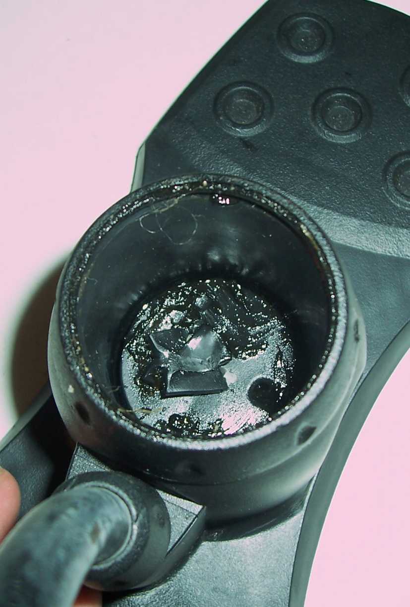

I put it away and didn't use it for a week, then used it fill up my hybrid, but I couldn't get past 10psi before I heard an airleak. Suprisingly, the leak wasn't from my hybrid, it was coming from the pump. It was coming from the BOTTOM of the pump, which is supposed to be a solid piece of plastic.
Now, thoroughly PO'd at bell, I took it apart, and found this inside. What appears to be chunks of scrap plastic were melted into the housing at the bottom. At first I thought I might have caused something to melt from the heat of compression, but I hadn't hardly use it yet.
What's worse, my old pump had sat outside over the winter, and also about 3 months worth of rain, and I could still use it. It was just inconvenient, as the piston didn't seal reliably.
I wasn't able to find the leak, but I think it's coming from inside the check valve, and somehow leaking out the underside.
Has anyone else had problems with bell? I can't return this, so I apparently wasted my money.

Go to Home Depot, go to the air tools section, (with the air-compressors, air fittings like Q.D.'s and such), and buy a Husky floor pump. Their only around eight to nine dollars and they last for a LONG time. Just don't go past around 100 PSI or try to pump up something ridiculous like a truck tire or a carry tank with it, as the heat of the high or sustained compression melts the little check-valve inside of it. I got one to pump my marble cannon up to 300 PSI before it finally crapped out, as well, so their a little more tough than your average bicycle pump.

couldnt you just install a metal check valve in the hose?markfh11q wrote:Here's what you can buy if you're not planning on going past 100 PSI and you want a little quality.

just go to the store and buy some CA glue the stuff is crazy. i was at someones house once filling up a 5 gallon air tank wit a bike pump. i got to about 80psi then suddenly a piece of the pump went flying accompanied by a rather loud boom and the hiss of leaking air. i turned off the tank witch had leaked down to about 50psi. then i went found the piece put a few drops of CA glue on it, put it back on the pump, and waited 15 min. the pump worked fine, no leaks. now since then i have switched to reg'ed co2 becuase i realized how annoying it was to pump a 5 gallon tank, but if you just need something temporary grab some CA glue
