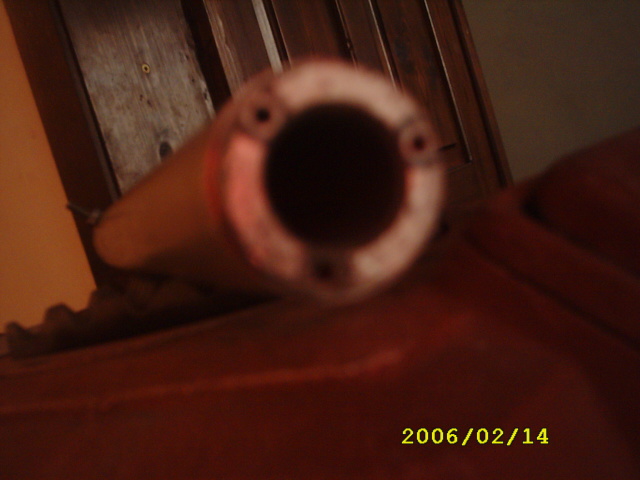

nicholai-Its already been done. Its called sleeving your chamber in couplings. I sleeved my soon-to-be hybrid with sch40 couplings. If you were to go about cutting the pipe, you would create weak spots were the cuts were made. The way to get around this is to grind out the ring stop on the inside of the coupling, and sleeve it that way.

yeah i dunno why i didnt think of that. i sleeved my 1.5" barrel with 2" sch 80 cause i thought id bust such a long barrel. and i ground out the male adapter so i could breech load spuds.
