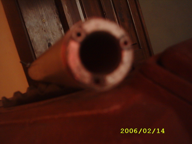

This is the strongest pipe i have.It can withstand much more then any hibrid.

i got an idea... what if you used 4" sch 80 pipe and made your chamber out of 4" sch 80 couplings and short cuts of 4" pipe? cut the small pieces of pipe so that the couplings would butt end to end. this would make a chamber of double walled sch 80. i suppose this would be great if the glued joints could be prepared well. It would also allow you to mount your electrodes on any spot of the chamber since its all double thick instead of just at the ends of the pipe.
or this could fail miserably where the chamber couplings are solvent welded together. what do u guys think?

I don't understand all these termins but even if I do, I don't have enough money to buy all these expensive pipes.In bulgaria I have never seen the end caps of the clasical spud gun and the pipes.... :(

nicholai-Its already been done. Its called sleeving your chamber in couplings. I sleeved my soon-to-be hybrid with sch40 couplings. If you were to go about cutting the pipe, you would create weak spots were the cuts were made. The way to get around this is to grind out the ring stop on the inside of the coupling, and sleeve it that way.

yeah i dunno why i didnt think of that. i sleeved my 1.5" barrel with 2" sch 80 cause i thought id bust such a long barrel. and i ground out the male adapter so i could breech load spuds.
im still toying with my hybrid, i scrapped the endcap idea i knew it would blow out. been messing with my propane launcher recently, i added a chamber fan and something new to the ignition, ill post it after i get outta work today.
I agree with Pimpmann, way to many weak spots! You should be thinking 1 piece chamber for strenth. I've seen threads that tell about lineing the inside of thier barrel, by sliceing a same sized pvc pipe leanth wise, to make it fit just snuggly inside your barrel. Doubleing the wall thickness.
Question to any one who has done it this way.
Did you solvent weld the slice before inserting the liner?
Can't the chamber be done the same way?
