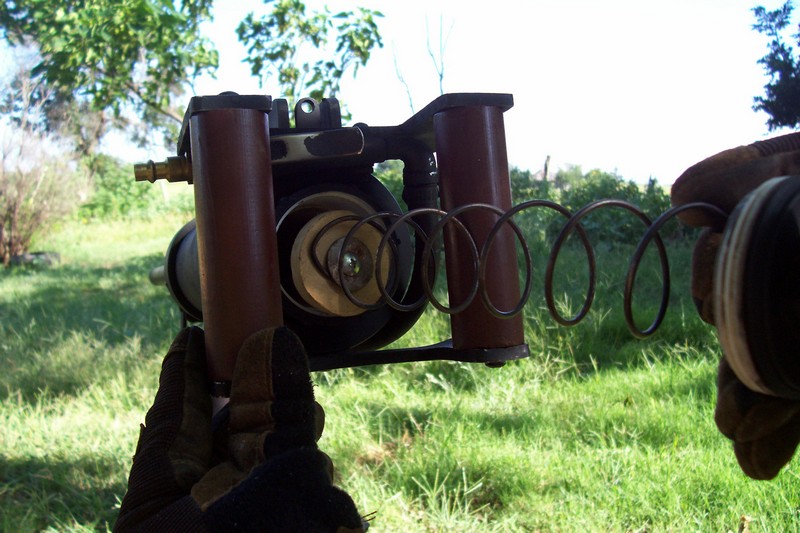

my first airsoft gun. i've worked on it for a couple months on and off collecting parts here and there and finally got it 99 % done. it has a 2" chamber that screws inside the 3" receiver and is hidden. the gun can be stripped down. in the vid im using 12 g. glow in the dark tracer bb's but want to try 20 g. when i have time i'm going to figure out the velocity.
34 inch barrel
50-60 rps
162 ft range with 12g bb's at 90psi
more details on my site

i cast this with scap aluminum in my backyard foundry
2" chamber with aluminum vortex block and brakeline barrel.
the charging handle on the right side doesnt do anything, just for looks.

I love the metal vortex block, what did you melt it down with?

Where did you hide the valve though?
spud yeti
Posts: 1030
I dont think there is a valve on the gun, I think its just the one at the air source :wink:
