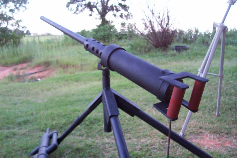

my first airsoft gun. i've worked on it for a couple months on and off collecting parts here and there and finally got it 99 % done. it has a 2" chamber that screws inside the 3" receiver and is hidden. the gun can be stripped down. in the vid im using 12 g. glow in the dark tracer bb's but want to try 20 g. when i have time i'm going to figure out the velocity.
34 inch barrel
50-60 rps
162 ft range with 12g bb's at 90psi
more details on my site
_______________________
http://www.freewebs.com/spuddin
http://www.freewebs.com/spuddin/50plans/m50plans.doc
i cast this with scap aluminum in my backyard foundry
2" chamber with aluminum vortex block and brakeline barrel.
the charging handle on the right side doesnt do anything, just for looks.

Beautiful! It looks like a .50cal MG! Is the tripod made of metal or pvc?
Spuddin
Posts: 262
Location: Oklahoma
i made the tripod out of 1" metal pipe.

Backyard foundry, that sounds interesting. I also like the design of the handle you have at the back. Nice gun

I love the metal vortex block, what did you melt it down with?

beautifully finished, you achieved the M2 feel very well :) well done.
Where did you hide the valve though?
spud yeti
Posts: 1030
I dont think there is a valve on the gun, I think its just the one at the air source :wink:

But right back on topic, what is the handle at the back of the gun made of?

Add an LRB :o . What's your airsource?
