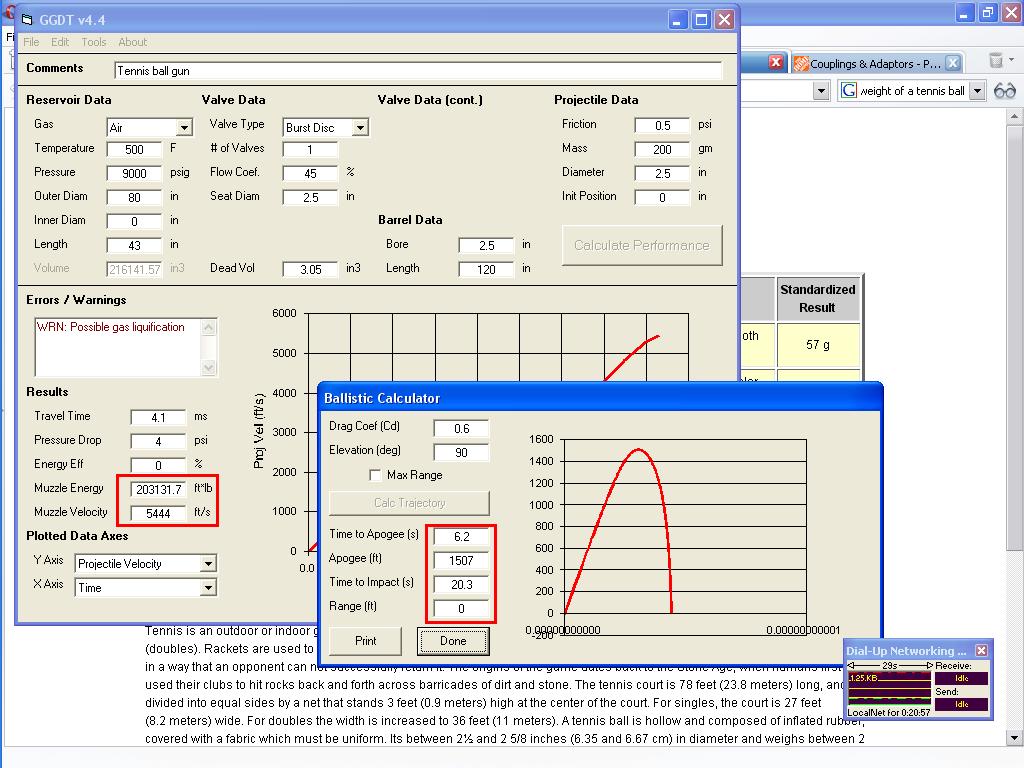

A tennis ball will not reach an apogee of 1/2 mile.
Maybe if you filled the tennis ball with something like metal or concrete, it would be able to fly that far, but only with a very powerful gun. A normal tennis ball would probably have to be going several miles per second, but it would just burn up at that speed.
They are good looking launchers, but I don't think you're going to sell them here.
Here is a quick ggdt calc of a weighted tennis ball weighing 200 grams.

I will admit there is artwork in those, especially the Nuker 2. They are good looking cannons. But seriously, the 20 bucks for the pressure rated parts was too much?
Especially if you were planning on selling it.
@Fnord
How did you get GGDT to do that, did you just trial and error it until you got the apogee you wanted?
I also love the 9000 psi
Good luck with that
I love the gas liquification warning, too
Just out of question, has anyone's hybrid hit ranges like this? A big hybrid is the only gun I can picture with even near this purported performance.
@Fnord

The numbers are a bit irrelevant, as I couldn't get a tennis ball to go any high than 1500 feet or so. I tried adding even more power, but the EBC wouldn't calculate such high numbers.
Also, a tennis ball has a higher drag(because of the fuzz) than a perfect sphere, which is 0.5.
A golfball is around .3.
Edit: just read the description on the site, which said it could launch a large potato in excess of a half mile. Well, I figured that would be a bit different.
I figured the density of a potato via water displacement, and found they are a little more dense than the water itself.
I calculated a good sized potato for that barrel would weight about 250 grams.
I ran the calculation again and got a maximum of about 1800 feet, again with 9000 psi of 500 degree air.

But your not firing a solid fuzzy sphere - it'll change it's shape at high velocities and adopt a more bullet like shape._Fnord wrote:The numbers are a bit irrelevant, as I couldn't get a tennis ball to go any high than 1500 feet or so. I tried adding even more power, but the EBC wouldn't calculate such high numbers.
http://scienceworld.wolfram.com/physics ... cient.html
