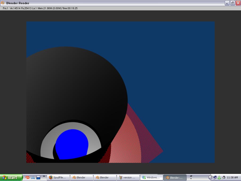

ok, lately ive been thinking of making an electrolysis machine, and ive been trying to think of ways to make it faster or more efficient. I would like input on which ones will work, and for the ones that work, which one would be the most efficient.
in the pics the things are kinda color coded:
the blue and red are the opposite electrodes
and white or grey is pipe
and dont yell at me for bad pics as i only had bout 20 min to make all three
and imagine that this all is inside a container
this one uses a solid electrode and a mesh or screen electrode
this one uses two sheets rolled into a tube for the electrodes
this one uses many rods the alternate polarity

The design of an efficient electrolysis cell is really pretty straight forward.
Rule number one: The electrodes should be plates and not wires. The larger the surface area the faster the cell will produce hydrogen and oxygen. Usually, the electrodes are simply flat plates.
Rule number two: The plates should be as close together as possible but not so close that the bubbles stick between the plates.

ooo, that helps alot, thank you
but with that example i cant figure out how he separated the H2 and O2
He doesn't, he just let it mixes.
And for this application stainless should work fine, expecially if you get extremely high quality. I used cheap home depot stainless steel hardware and after tens of hours of use I have yet to see any corrosion.
Just a suggestion, but if you wanted to seperate the gases, you could use stainless steel plates and seperate them by a thin sheet of plastic (but allow water to surround the entire plate, maybe a 1mm clearance). and then have a gap at the bottom so water can pass through the entire inclosure but the gas will not pass between paltes and mix because it goes upward. Anyways just my two cents.
