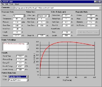

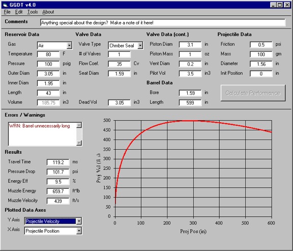

jackssmirkingrevenge wrote:There is no "maxium range" - the longer your barrel, the further it will go, simple is that (provided your ratio of barrel to chamber volume doesn't fall below 4:1 or so) - so basically, make it as long as you can afford.
Almost.
There is both a maximum range and an optimal barrel length for a fixed chamber size for a pneumatic gun. (See attached GGDT output)
For a fixed barrel length there is no optimal chamber size. If everything else is equal, then the larger the chamber the higher the muzzle velocity (though the velocity versus chamber size approaches a limit asymptotically).
GGDT output using all default values except for a very long barrel. Velocity plotted as a funtion of projectile position (barrel length)
Almost.
Hence why I did not specify a fixed chamber size in my example ;)
