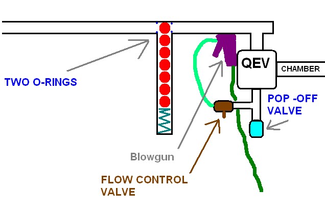

Is a bolt really needed ?
I think this might work better than a blow forward breech design... you only have to make chamber as small as possible and use o-rings so that only one round is fired per 'shot'
JSR don't mention that dead space - it's just a rough sketch ok?;
(the flow control valve is to adjust the ROF)
so.....would this work ?
A double post?!? i thought better of you JSR
Oh come on, you know I'm not a post whore, and if I had just edited the previous post no one would have noticed ;p
POLAND_SPUD, what you're proposing is essentially similar to this design, only the latter uses an airflow driven paddle to interrupt the flow of ammunition per shot (though not preventing the air from getting into the chamber).

Yes JSR I've seen that gun before.... but is that paddle really needed ? if the magazine tube has ID as close to the caliber of the ammo as possible the flow of air would act on the rest of ammo in the magazine for a fraction of second - keepping it out of the barrel (and blocking the air from entering the magazine tube and therefore limiting dead space
What are advantages of this blow forward design over this design ?
For me the advantage is that you're not limited to a spring loaded mag, you can just feed from a hopper like paintball markers do.

I think there would also be a problem of some air traveling inside the magezine/hopper instead of the barrel, if a bolt isn't used.
