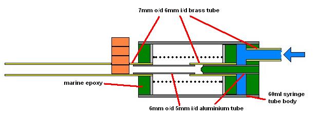

JSR can you tell me what the part of the valve that slides into the barrel is made of? Like if it is a common household object.
Here's a breakdown of the parts. All the tubing was purchased in one metre lengths from a hobby store, but you can find it online too.
