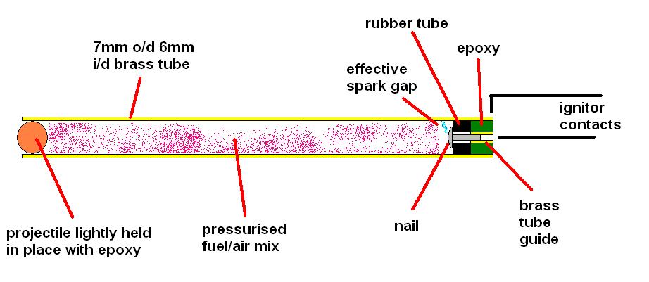

I still believe that the best solution here would be a hybrid cartridge. I drew up a design that might work - basically the rear end is a non-return valve which also provides a spark gap. The fuel would be metered in through the back with a syringe, then to add the compressed air the 6mm tube fits nicely into the cam-locking style seal like the one on this foot pump - you could also build a chamber with a premixed concoction of fuel and air and just fill once, but it would probably be tricky to get a homogenous mix - not mention the dangers of having a large quantity of premixed fuel.

Are you thinking something along the lines of this...
...when you say blow forward breech? (yes I know it's your design).
The problem I saw with that, was the cluttered chamber, don't forget you've also got to get a ignition source in there as well. Also there's the problems of sealing things when the seals are exposed to heat.
The reason, I've taken the "blow-forward piston" out of the chamber is to cut down on the need for seals (your's needs two sets - outer piston to chamber and inner piston to rod) whereas mine needs fewer seals which would hopefully be easier to put in place.

You're right, that is a little complex, maybe you can adapt the second version I made - blow forward bolt version 2 than involved a lot less precision casting.
You couldn't need to have the ignition etc within the mechanism, the idea is that the exploding mix vents through a port that feeds the breech.
