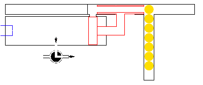

Ever since I first saw a hybrid I've been trying to work out my personal Holy Grail - the 177 auto-hybrid. In fact it was what got me into spudgunning in the first place, the quest to make my own air rifle. I think I've finally cracked it.
The downside is, I know it'll probably involving machining and a level of work I'm not equipped to carry out, so I thought I'd throw it out there, make it open source and see what people think, work on refining it together, and maybe someone will actually build one. So, for now, here's a schematic I've left a couple of bits out but I think it's clear.
Firstly the ignition group. I'd imagined a small coil set up with a microswitch to trigger it. It allows for instant recharging, and should give a good spark.
Secondly the fuel tank. Because it's a small calibre high pressure hybrid it should be perfectly possible to use a pre-mix fuel/air set up running through an adjustable regulator into the 3-position ball valve shown. Obviously care should be taken to avoid this ignition, but I imagine building it strong and giving it a burst disc in case of ignition within.
Thirdly, various springs and levers. It's only a schematic, not a working diagram so for ease I left out the spring behind the piston, and also any levers going from a trigger group to the valve, and ignition switch.
I imagine building the whole thing into a rifle set up. An under barrel fuel tank would work well in this case (burst disc at barrel end). I also imagine some kind of helical pressurised magazine as discussed in another post on here, but a straight underbarrel would be fine and a hopper at a push.
So the firing sequence.
1. Empty - trigger is forward, three way valve is venting chamber to air.
2. Fueling - trigger is half way back, valve is open to fuel tank and chamber is filling.
3. Ignition - trigger is fully back, valve is closed chamber is sealed, microswitch opens and ignition fires.
4. Chambering/Firing - pressure builds, piston rushes forward, bb is chambered and magazine is sealed.
5. Purging - trigger is half way back, valve is open to fuel, fuel enters chamber alongside combusted gases, chambers is pressurised.
6.. Exhaust - trigger is fully forward, valve is open to air, chamber is venting exhaust gases.
Repeat.

Alright, I was keeping this to myself, but for the sake of open source I guess I'll share it, since I don't think I'll be able to put it together any time soon.
It's a "turbojet" stuck to a steel BBMG, nothing more. I know Cptn law has a jet already built, but I don't think he posts here anymore.
This design is also open to suggestions and improvments.

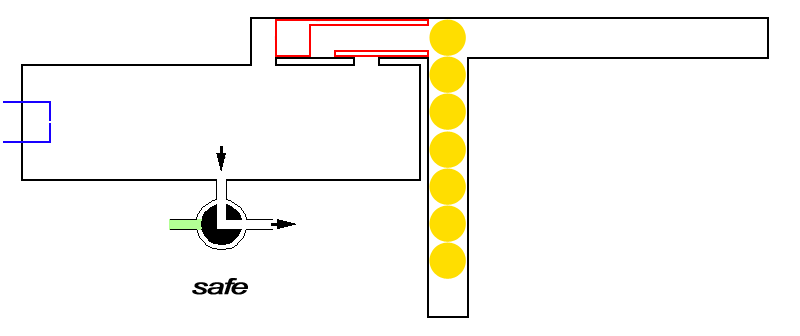

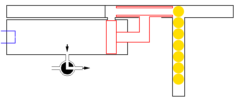

Overnight I came up with this revised version, which reduces deadspace, reduces piston size (less power loss) and seems to me to be much simpler.
Now, who's capable of drawing this up in 3D?

I would think the piston or bolt or whatever you call it, would begin to move due to the chamber pressure before it is ready to fire.
You could have a blow-forward valve instead and adjust spring strength so it resists the mix pressure but moves when the mix is ignited.hubb017 wrote:I would think the piston or bolt or whatever you call it, would begin to move due to the chamber pressure before it is ready to fire.
edit: if anyone makes a prototype, I hope for their sake it doesn't explode, lest they be forced to endure "open sores hybrid" jokes

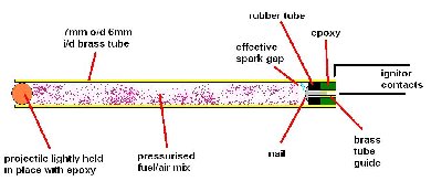

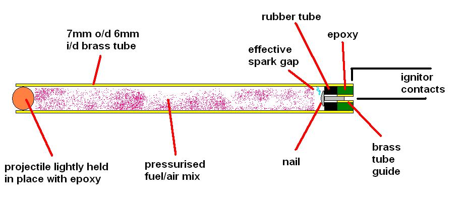

I still believe that the best solution here would be a hybrid cartridge. I drew up a design that might work - basically the rear end is a non-return valve which also provides a spark gap. The fuel would be metered in through the back with a syringe, then to add the compressed air the 6mm tube fits nicely into the cam-locking style seal like the one on this foot pump - you could also build a chamber with a premixed concoction of fuel and air and just fill once, but it would probably be tricky to get a homogenous mix - not mention the dangers of having a large quantity of premixed fuel.
Are you thinking something along the lines of this...
...when you say blow forward breech? (yes I know it's your design).
The problem I saw with that, was the cluttered chamber, don't forget you've also got to get a ignition source in there as well. Also there's the problems of sealing things when the seals are exposed to heat.
The reason, I've taken the "blow-forward piston" out of the chamber is to cut down on the need for seals (your's needs two sets - outer piston to chamber and inner piston to rod) whereas mine needs fewer seals which would hopefully be easier to put in place.
Hybrid carts sound fun, and I'd love to see them in action, but there's several issues I personally have with them.
1. Fiddly fuelling - having to load each one individually just would spoil all my fun.
2. Repeated manufacture - I'd get bored making fifty cartridges.
3. Power loss, in cycling the action.
That's not to say I don't think it's a great idea, it's just not my tasse du thé
And Hubb and Felix, the piston/bolt doesn't move forwards as it would be held back by a spring, I just didn't put them in (like I said in the OP) because drawing springs is fiddly.

You're right, that is a little complex, maybe you can adapt the second version I made - blow forward bolt version 2 than involved a lot less precision casting.
You couldn't need to have the ignition etc within the mechanism, the idea is that the exploding mix vents through a port that feeds the breech.
