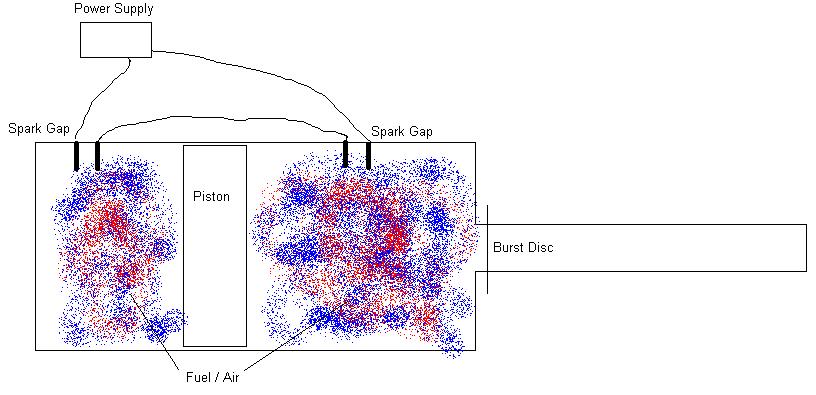

Here's a thought: What if the piston was forced through combustion? Essentially, the launcher has "two chambers" and a piston separates the two. When the rear chamber is ignited, it forces the piston forward. The chamber closest to the barrel (primary chamber) is ignited. The piston will compress the burning gases in the primary chamber and...well, the rest can be figured out.
This diagram may help to better understand it
SPG
Posts: 364
Joined: Thu Feb 09, 2006 11:55 am
FeLeX thanks, hope it helps, they're cheap as chips those guns, so should be easier to make up.
Compression by pre-combustion? Well tis a bit complicated isn't it? and it's need a twin chamber system, which would incease size of the gun, which isn't the aim of this simple mini-self-pressurising-hybrid.
Zen///
Posts: 278
Joined: Sat Oct 27, 2007 3:49 pm
Location: In a foxhole sniping,Calgary, Canada
Hubb good idea but the hard part would be timing the ignition, and would use more fuel, if he has a lathe he could make the chamber fit on a caulking gun, the psiton attached to the "metal circle that puches the caulking". And just fuel it, pump the caulking gun till the desired pressure, and ignite.
