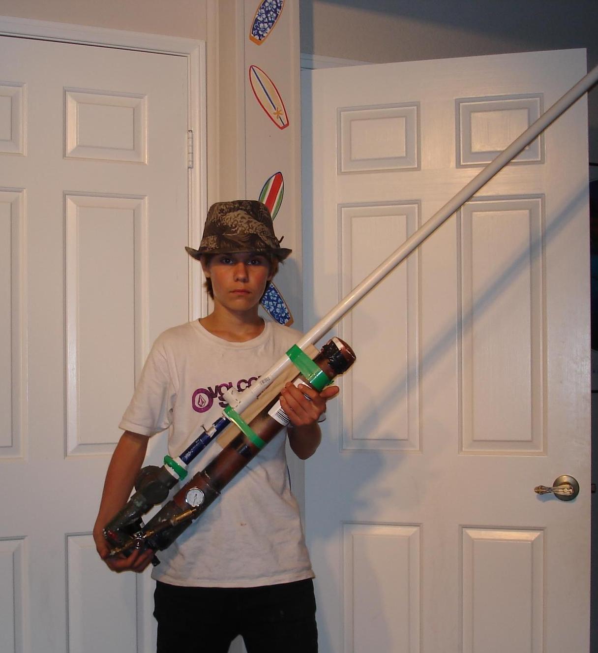

this is my attempt in many fields for a pneumatic. i assure you i've made many pneumatics before but was to lazy to post them but i had free time for once so im posting it.
>gun 70"

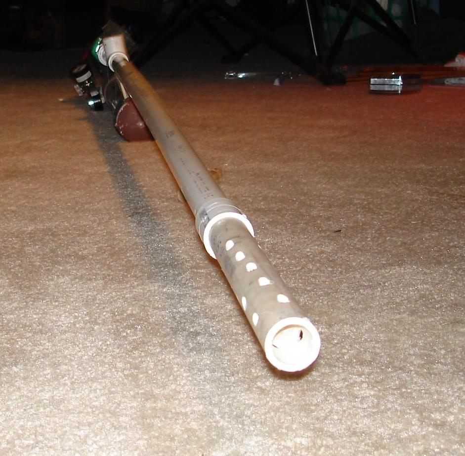

>barrel+bolt+silencer 61"(3/4" of sch 40 pvc)
>champer is 24" of 2" sch 40 pvc

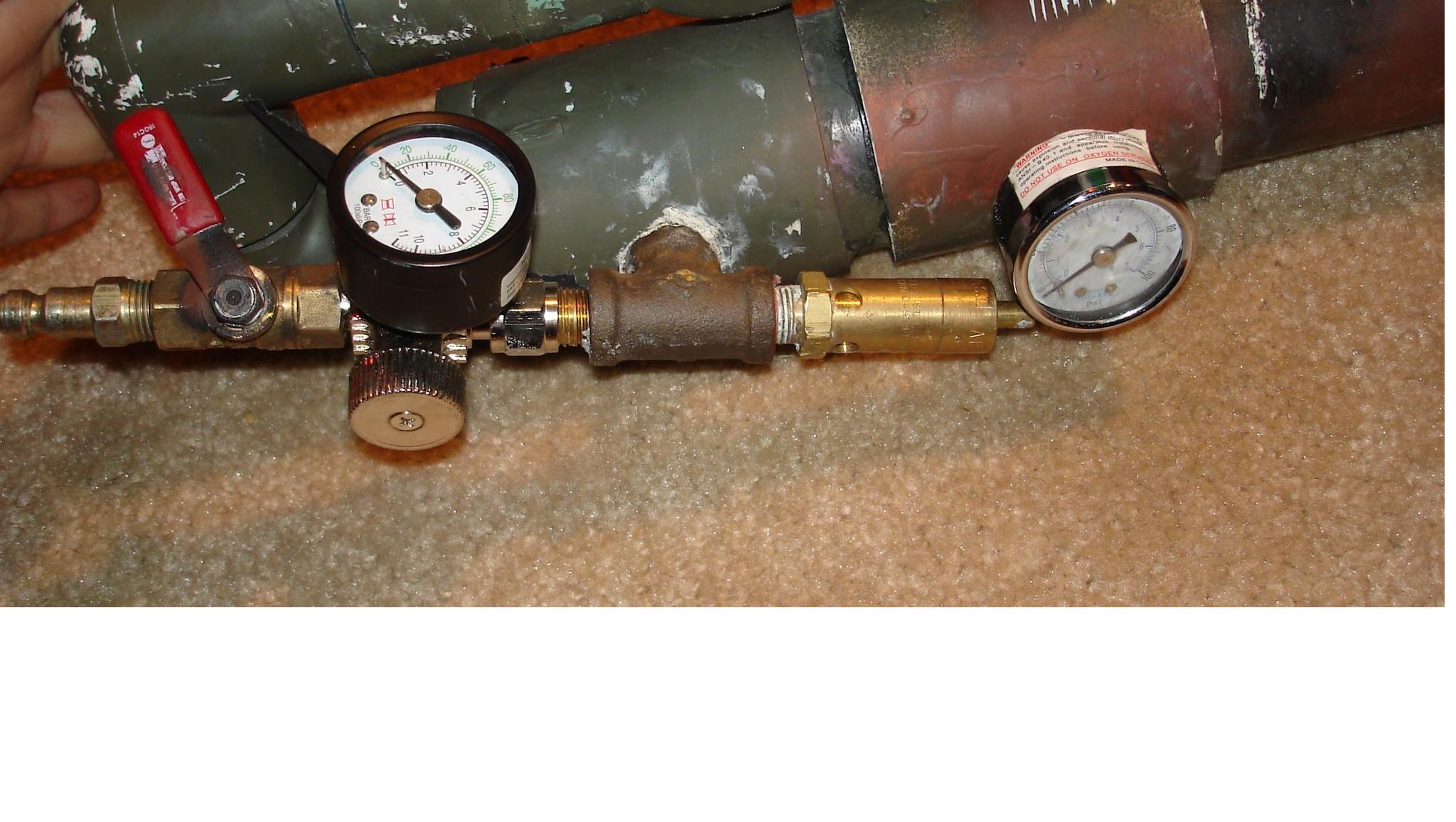

>has 4,500 psi relief valve
>tank gauge up to 100 psi
>regulator up to 160 psi
>has 1/4" ball valve (safety)
>could be outfitted with the same style of pump barrel as "origin unknones" m-1 frag fast reloading airpowered gernade launcher.
and i am currently prassueing to make the seme loadind system as the "GB semi"
realy long paintball cannon

get some damage pics/vids up. and i REALLY like that muzzle brake. Like really. Might have to steal that one from ya if you dont mind

May i ask why you bothered with the 4500psi relief valve if you only charge to 160psi?

yah thats what i was wondering
i like that muzzle break

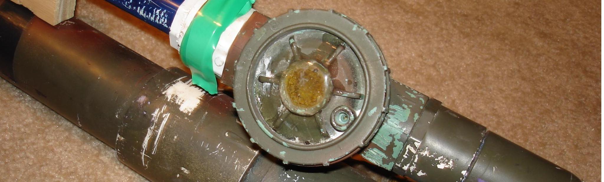

It looks as though it is meant to be piloted through the sprinkler valve, however there is no hole to accommodate a hose... Activation occurs by pressing the 4500psi relief valve i assume.

Wow you could get a lot better performance then what you get now if you stick a damn blow gun on the thing, if i see correctly, your piloting it through the 1/32" hole for the solenoid!
Drill a hole, stick a blow gun in it, and your done.
