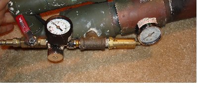

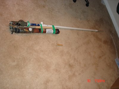

this is my attempt in many fields for a pneumatic. i assure you i've made many pneumatics before but was to lazy to post them but i had free time for once so im posting it.
>gun 70"
>barrel+bolt+silencer 61"(3/4" of sch 40 pvc)
>champer is 24" of 2" sch 40 pvc
>has 4,500 psi relief valve
>tank gauge up to 100 psi
>regulator up to 160 psi
>has 1/4" ball valve (safety)
>could be outfitted with the same style of pump barrel as "origin unknones" m-1 frag fast reloading airpowered gernade launcher.
and i am currently prassueing to make the seme loadind system as the "GB semi"

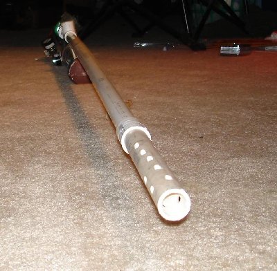

I personally think it needs a nice paintjub but otherwise SWEET!!!
get some damage pics/vids up. and i REALLY like that muzzle brake. Like really. Might have to steal that one from ya if you dont mind :-)

May i ask why you bothered with the 4500psi relief valve if you only charge to 160psi?
spudling
Posts: 48
Joined: Fri Oct 27, 2006 10:17 pm
it was laying around

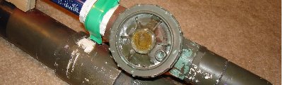

this is gonna sound stupid but... how do you fire it? i see nothing connected to the sprinkler valve to actuate it...?

yah thats what i was wondering
i like that muzzle break

It looks as though it is meant to be piloted through the sprinkler valve, however there is no hole to accommodate a hose... Activation occurs by pressing the 4500psi relief valve i assume.

nop im just puting my thumb over the hole and when i take it off boom. the pressure isnt that strong

spudling wrote:nop im just puting my thumb over the hole and when i take it off boom. the pressure isnt that strong
What hole?
edit: the hole in the valve?

on the solanoid where you usaly mount a blow gun
Well that sounds really safe.

o thanks im going to mount a blow gun tomorrow and videos will be in soon
Wow you could get a lot better performance then what you get now if you stick a damn blow gun on the thing, if i see correctly, your piloting it through the 1/32" hole for the solenoid!
Drill a hole, stick a blow gun in it, and your done.
