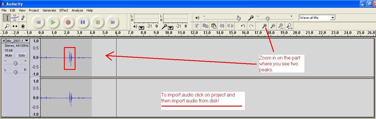

This post will give u instructions to measure the speed of your projectiles shot:
Materials needed:
1. mp3 player with recorder (or mic on a computer)
2. audacity audiosoftware
http://audacity.sourceforge.net/latest/ ... -1.2.6.exe
3. 'ruler'
4. metal target
Method:
1. Set the target at 26.2 ft
2. Start recording using ur mp3 or mic on the computer
3. Shoot the target
4. Put the audio file on your computer
5. Open audacity
6. Import audio (via button project)
7. Please look at the pictures I posted> further instructions there
Calculation:
Speed in ft/s = [8/(time taken-(0.02353))]*3.3
>>Speed = [Distance/(time-(distance/speed of sound))]*m/s to ft/s conversion
Thats it! Takes about 10 minutes first time>pictures should help. Plz post if you have questions or comments.

If you used AUDACITY the sound becomes visual like in the pictures I posted, this makes it easier to analyze to my oppinion. But yeah you sound like you have a very trained ear, respect. But what I am trying to say to all the other users is that for a pneumatic/bb gun u dont need a trained ear to get this right as everything can be done visually.BigGrib wrote:i have been manipulating sound for quite a while, i mean i've been doing radio for over 10 years i can hear a pindrop from a mile away trough my headphones, and i have been listening to some of my recordings, slowing them down by the power of 10 and i can actually hear the difference in the sound right when the projectile leaves the barrel, there is a change in pitch, not too much but it is noticeable to the trained ear, that is with a pnuematic anyway. with a combustion it's a lot harder because of the bang, the projectile actually leaves the barrel before the bang is finished.

I chose 26.2 ft (8m) inorder to make it easier for ppl to calculate. I dont think all ppl here get what we are talking about, so I tried to make it as basic as possible. A larger distance means that u have less error. But ofcourse it wont give u the muzzle velocity rather the average as I said before.jimmy101 wrote: Your muzzle to target distance does not have to be so large, nor does it have to be 26.2 feet. All you need to know is the distance from the muzzle to the target. I would suggest a much shorter distance since the projectile is slowing down pretty quickly and this method (indeed all chono methods I can think of) give the average speed over the measured distance.
