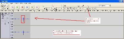

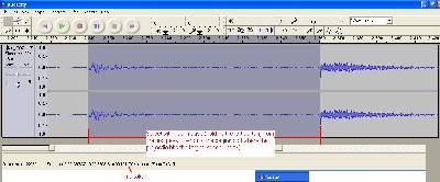

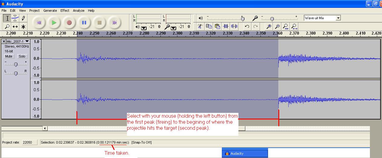

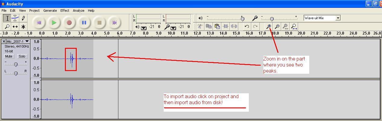

4. metal target
Method:
1. Set the target at 26.2 ft
2. Start recording using ur mp3 or mic on the computer
3. Shoot the target
4. Put the audio file on your computer
5. Open audacity
6. Import audio (via button project)
7. Please look at the pictures I posted> further instructions there
Calculation:
Speed in ft/s = [8/(time taken-(0.02353))]*3.3
>>Speed = [Distance/(time-(distance/speed of sound))]*m/s to ft/s conversion
Thats it! Takes about 10 minutes first time>pictures should help. Plz post if you have questions or comments.
