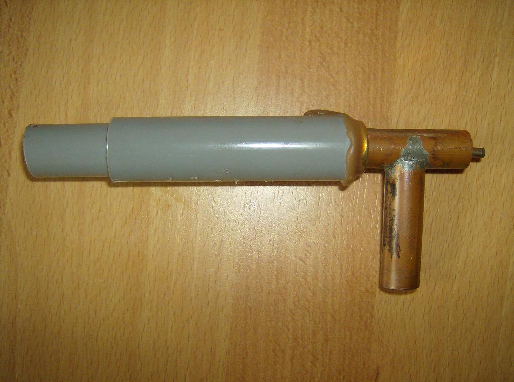

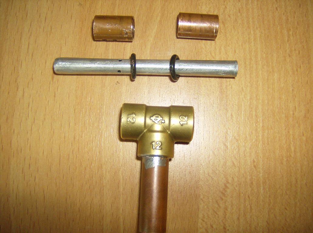

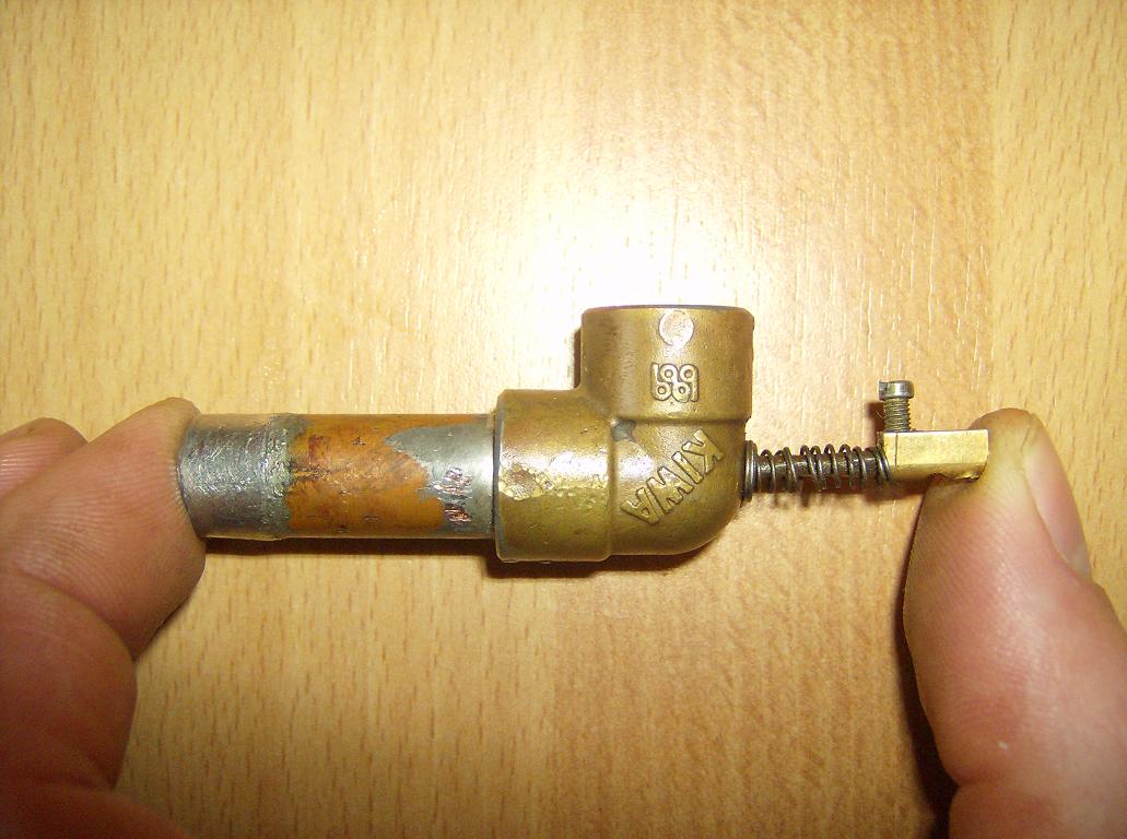

Different kinds of valves I made and that work:
1 Poppet valve with ballpoint spring, 90 degrees bend flow
2 Tippmann type of valve, two poppet valves on two sides, can be used for blowback designs
3 Drozd sliding valve, slides forward and takes a bb then gives a burst of air
P. 5 Homemade valves

again, very impressed with what you manage to accomplish using only basic parts and facilities, kudos for thinking out of the box

wow nice valves although i don't quite understand what stops all the air being released on the stacked tube valve design?
On the animation of the green part is a screw it has a spring at the back which keeps it closed. The o ring is colored red. When the hammer (brown) hits back the poppet valve gives a short burst of air. Bc of the air pressure and the spring behind the valve it closes again.ALIHISGREAT wrote:wow nice valves although i don't quite understand what stops all the air being released on the stacked tube valve design?

very nice, these popet valves are just like the ones on blow guns but usually when you make them much larger they become too hard to operate so it requires the force of a nice hammer blow I've recently noticed that moded pizeos can be used to made hammers to strike the valve instead of the piezo crystal
oh and the holes on valve 3 are way too small if your afraid of making it too long (but so for its fine) you can make a slot probably with a saw
the rod on valve 1 is not quite clean enough looks like you ghetto drill press lathed it, do you have some tap and dies you could thread the tip of a rod and add nuts and a washer or sleeve it in some tubing

Yeah you are kinda right. The problem is that the holes are not supposed to rip open the orings lol. So yeah its kinda hard. But my main problem on the sliding valve is that it moves really ...viscid. Too slow for fast operation due to the orings.iknowmy3tables wrote: oh and the holes on valve 3 are way too small if your afraid of making it too long (but so for its fine) you can make a slot probably with a saw

also for some seals your may want to try the threaded rod and sheet rubber between washers thing you need washers that practically touch the walls of the pipe, in my case I had to grind down larger washers, for sheet rubber I used a tire tube the great thing about this is that you can ajust the seal by tightening the nuts that squezes the rubber out ward
