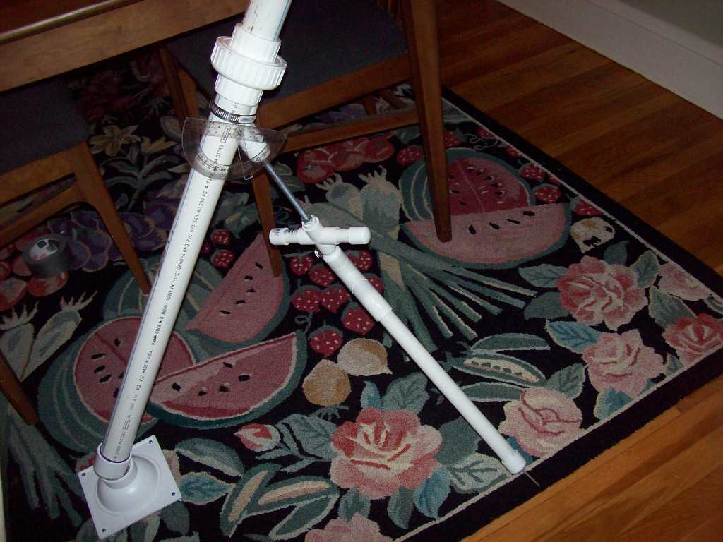

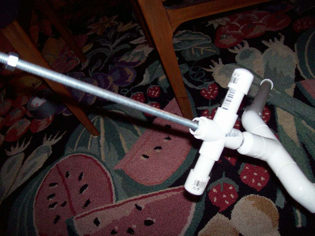

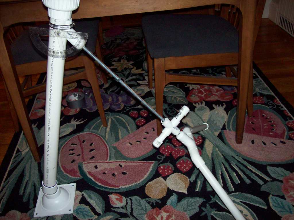

hey, i had this mortar prototype working, but i just finished the stand today. It's got a 6"x6" (drum bell?) for a mount. Its held up by a bipod with a 3/8" thread to raise/lower height. You do this by twisting the 1/2" 4-cross either way. It works very simply. Its like a burst disk except i stop pumping and drop the round down the muzzle. The nail hits the foil in the union and it bursts. dangit. I put the pics in backwards :x

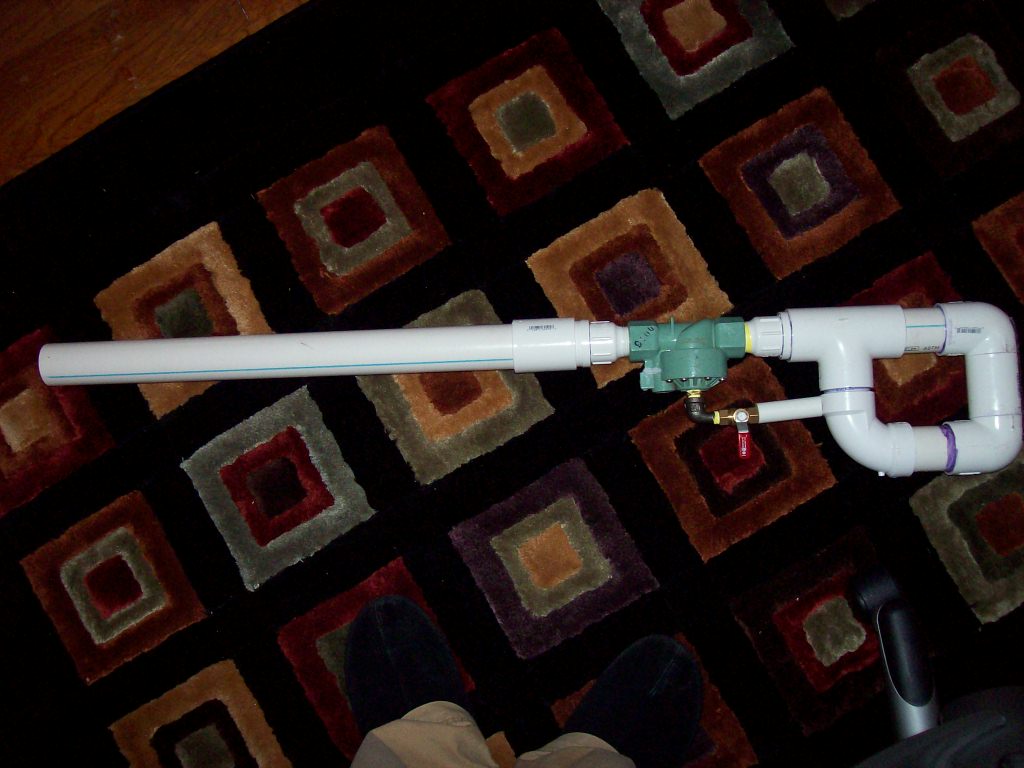

heres another gun i made that was lying around.

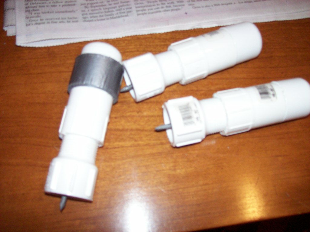

mortar rounds, note the protruding nail.
60 deg.
60 deg.
75 deg.
75 deg.

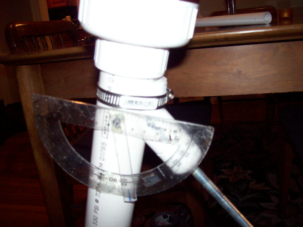

angle measure
angle measure
Pic of the angle adjuster.
whole mortar.
whole mortar.

I like your rounds. How well does it shoot? I really like your other gun. Specs for both maybe. :lol:

looks nice what kind of height do you think this is getting. i also love the nail in the bottom of you ammo that pops the disc.

I like your other pneumatic also... It reminds me of my PB Pneumatic... I made a stock out of a 45 and (2) 90s though...
Very terrible primer job compared to most of my work if I do say so myself :) I think it was because I was mad, due to my local Home Depot not selling 1" NSF-PW Wye fittings... and I didn't want to use a 1" tee + a 1" 45

dont really know for sure. ive been meaning to actually get it out to an open area. I did some preliminary testing it in my backyard. 35 psi was enough to hit my neighbor's roof. Too lazy for specs, sorry amigo. If you want a specific measurement i'd be glad to tell ya.

Well will you please tell me. I am very interested in the other gun.

Very nice mortar, I'll bet it's pretty loud :D I also like the other pneumatic, but one of the fittings on it is dwv (not pressure rated), so I would suggest replacing it, or keeping the gun below 50 psi. The dwv fitting is the rounded off 90 degree elbow.

:cussing: I didnt recognize the dwv! that pisses me off. I could usually only take it to 40, but i just epoxied a leak in the sprinkler so i was gonna us it at 100... thanks tho, that just about saved my life. Well, i am gonna hand load them. Its not an issue because, like a real mortar, the round's diameter is a little smaller than the tubes, so because of berlin forces, it takes a little bit to hit the bottom of the tube (still enough to puncture tho.)
I dont really know what you want in terms of specs for the rifle. Its all 1.5" except the sprinkler. Its piloted with a 1/4" ball valve (much better flow and realisticness imo) on a 90. The pipe coming off of that is just 1/2" pvc i jammed it there to hold it better.

this cannon has inspired me to make my own. i finished it last night and tested it today. it passes with flying colors. i was lucky and found a near perfect round that already has a puncture pin on it. i shot it at around 100 psi. i dropped it in, heard a loud bang and never saw the projectile again. sadly, i didnt recover the projectile. with no more "mortar" rounds on hand, i just used it as a burst disk cannon.
what exactly do you make your rounds out of? is it 3/4'' pvc fittings with tape on it?

wow, i really love the ammo with the nail. could you post some damage pics? interested in the damage this thing can do.
