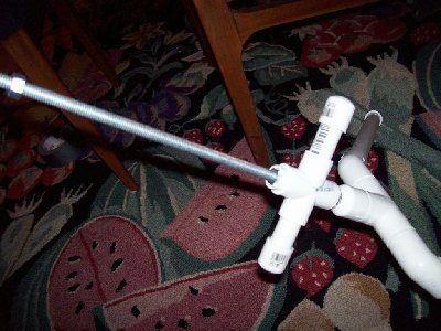

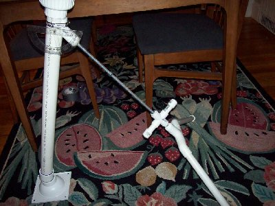

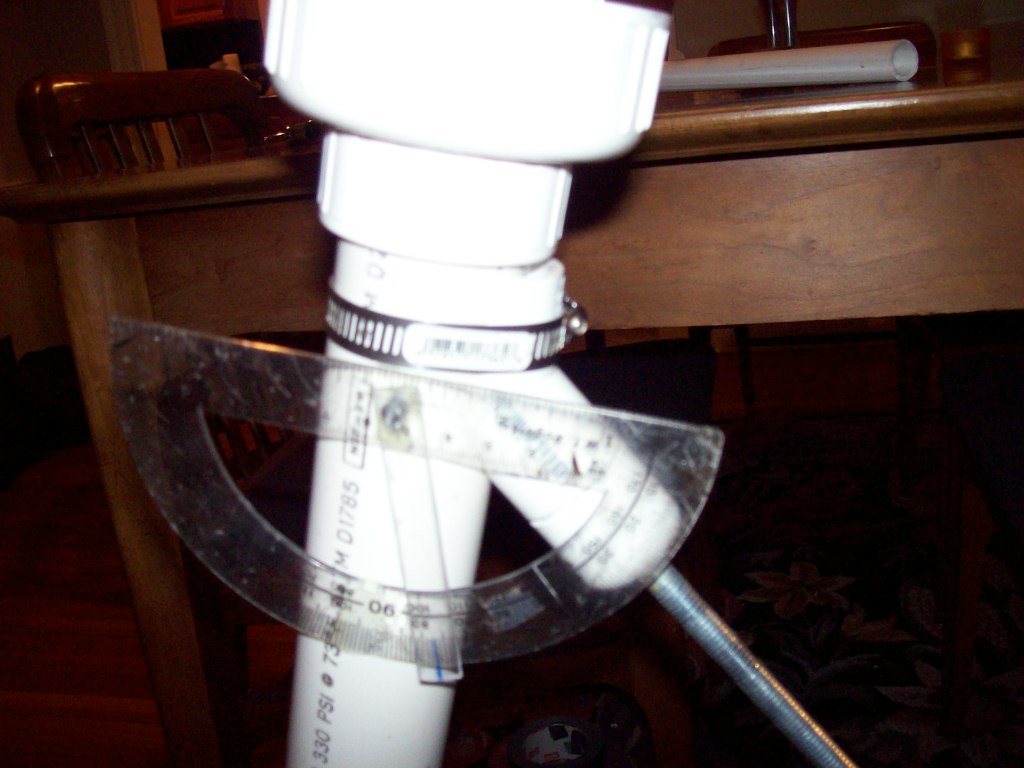

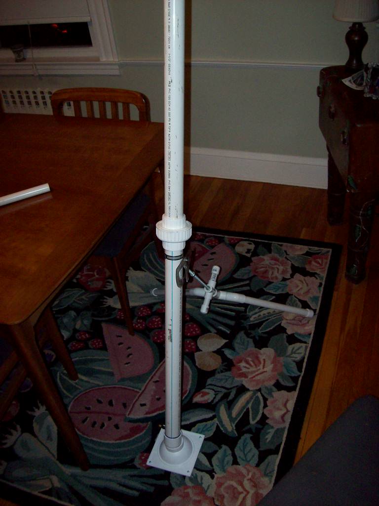

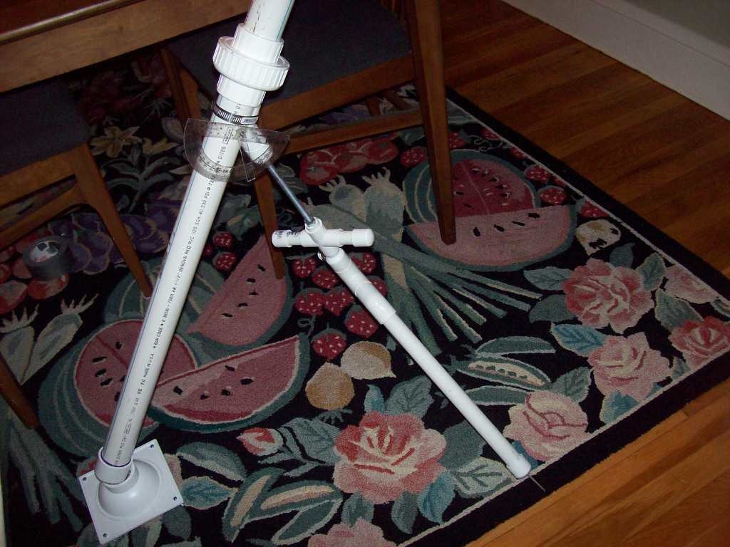

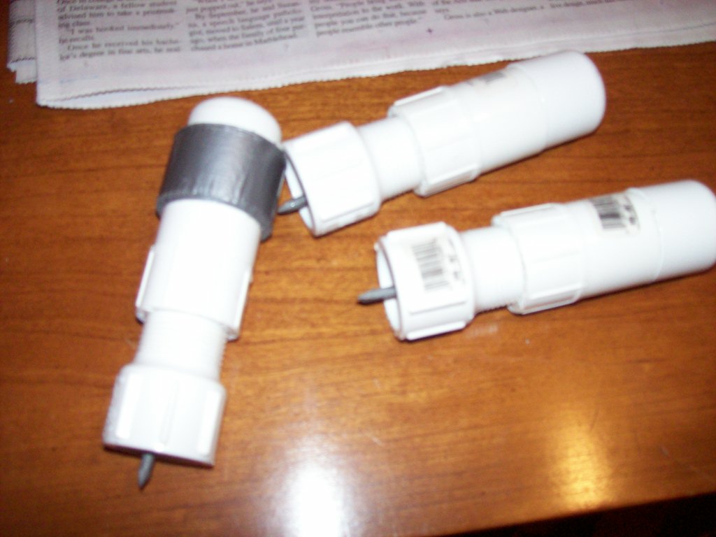

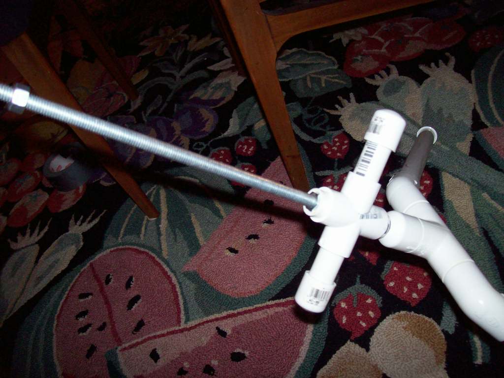

hey, i had this mortar prototype working, but i just finished the stand today. It's got a 6"x6" (drum bell?) for a mount. Its held up by a bipod with a 3/8" thread to raise/lower height. You do this by twisting the 1/2" 4-cross either way. It works very simply. Its like a burst disk except i stop pumping and drop the round down the muzzle. The nail hits the foil in the union and it bursts. dangit. I put the pics in backwards

looks nice what kind of height do you think this is getting. i also love the nail in the bottom of you ammo that pops the disc.

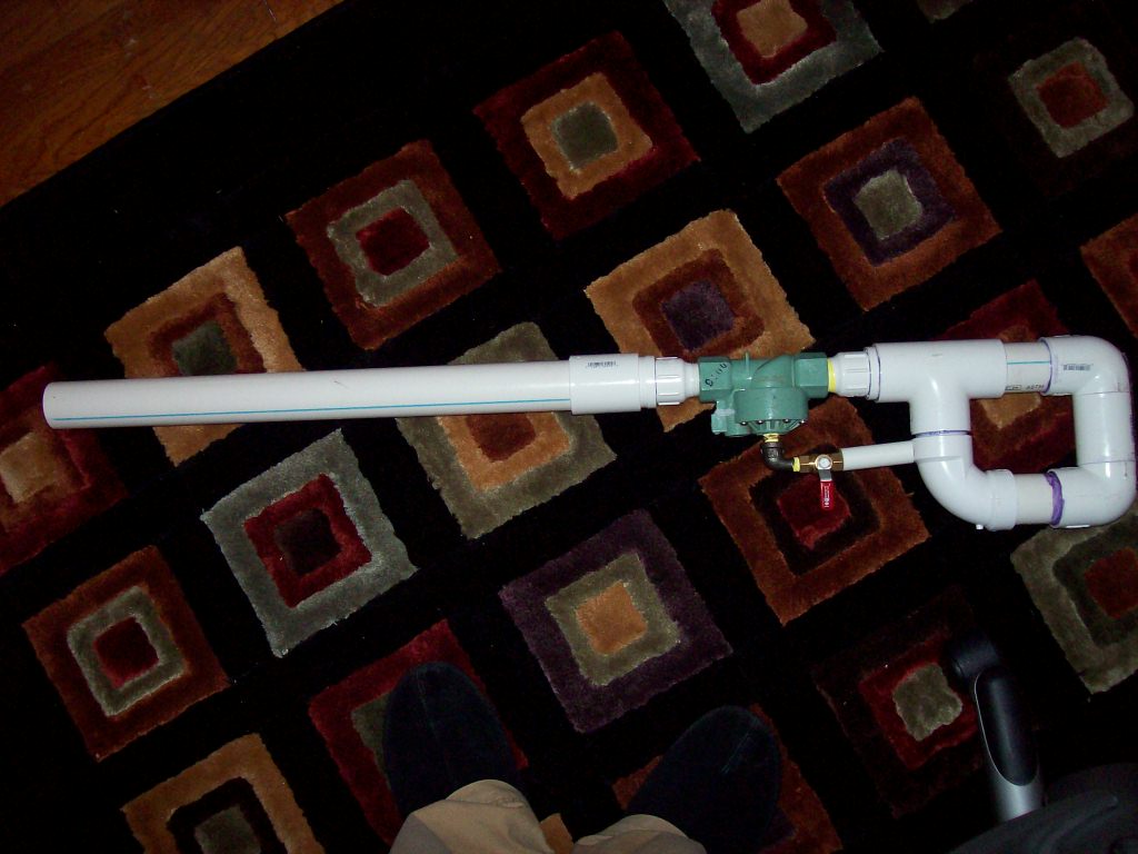

I like your other pneumatic also... It reminds me of my PB Pneumatic... I made a stock out of a 45 and (2) 90s though...
Very terrible primer job compared to most of my work if I do say so myself
I think it was because I was mad, due to my local Home Depot not selling 1" NSF-PW Wye fittings... and I didn't want to use a 1" tee + a 1" 45

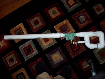

I also like the other pneumatic, but one of the fittings on it is dwv (not pressure rated), so I would suggest replacing it, or keeping the gun below 50 psi. The dwv fitting is the rounded off 90 degree elbow.

:cussing: I didnt recognize the dwv! that pisses me off. I could usually only take it to 40, but i just epoxied a leak in the sprinkler so i was gonna us it at 100... thanks tho, that just about saved my life. Well, i am gonna hand load them. Its not an issue because, like a real mortar, the round's diameter is a little smaller than the tubes, so because of berlin forces, it takes a little bit to hit the bottom of the tube (still enough to puncture tho.)
I dont really know what you want in terms of specs for the rifle. Its all 1.5" except the sprinkler. Its piloted with a 1/4" ball valve (much better flow and realisticness imo) on a 90. The pipe coming off of that is just 1/2" pvc i jammed it there to hold it better.

this cannon has inspired me to make my own. i finished it last night and tested it today. it passes with flying colors. i was lucky and found a near perfect round that already has a puncture pin on it. i shot it at around 100 psi. i dropped it in, heard a loud bang and never saw the projectile again. sadly, i didnt recover the projectile. with no more "mortar" rounds on hand, i just used it as a burst disk cannon.
what exactly do you make your rounds out of? is it 3/4'' pvc fittings with tape on it?
thanks for the inspiration... will post when painted.
