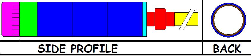

This is what my next gun will look like its a hybrid. This is what all the colors stand for in the picture.
Blue= 4" Sch 40 Coupling
Light Blue= 4x2 Bushing
Green= 4" Male Adapter
Purple= 4" Cap
Red= 2" Union
Yellow= 1 1/2" or 2" Barrel
Brown= Sch 80 4" Pipe
A couple of questions for you expert spudgunners. What is more powerful a camera flash or a spark plug (I should know this). I was wondering if i used golf balls for ammo could I use rubber stopper (like on a paintball gun) and not have to use the union (2x to 3x mixes).

you want sch 80 fittings too, sch 40 wont cut it, and you'd still need a union, because i dont think the stopper'd hold past 3 atmospheres of pressure

Good desgin, Personally i have never tried the camera thing, but i do use spark plugs with a 200,000Volt stun gun, i use 1 for smaller guns a 2 for bigger ones, i would go with the spark plug becasue i have heard that you have to replace the camers flash after a while becasue something wears out i think. Overall i would go with a stungun and a sparkplug set up. I made a hybrid with the spark plugs and it works good. Good luck tell us how it goes.

BTW- I use camera, can be a pain in the rump but it makes a big ball of sparks if done right.
