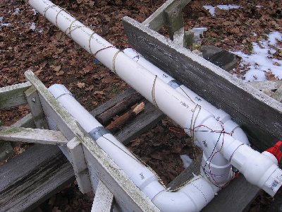

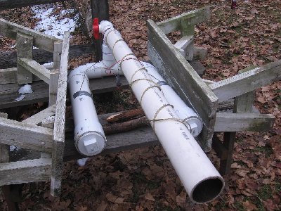

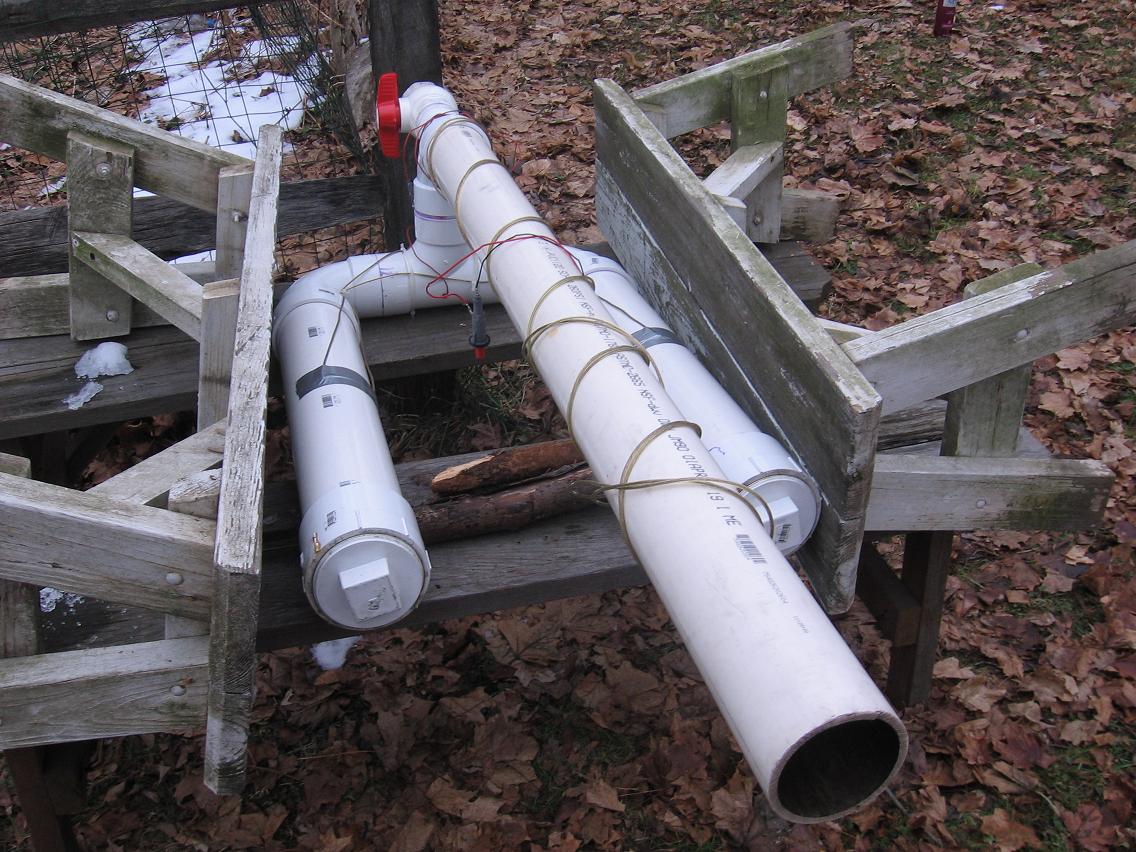

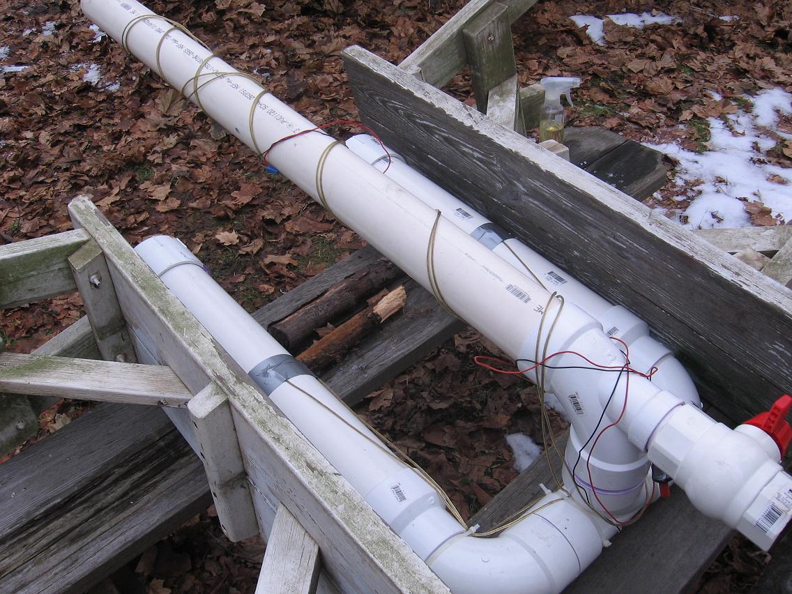

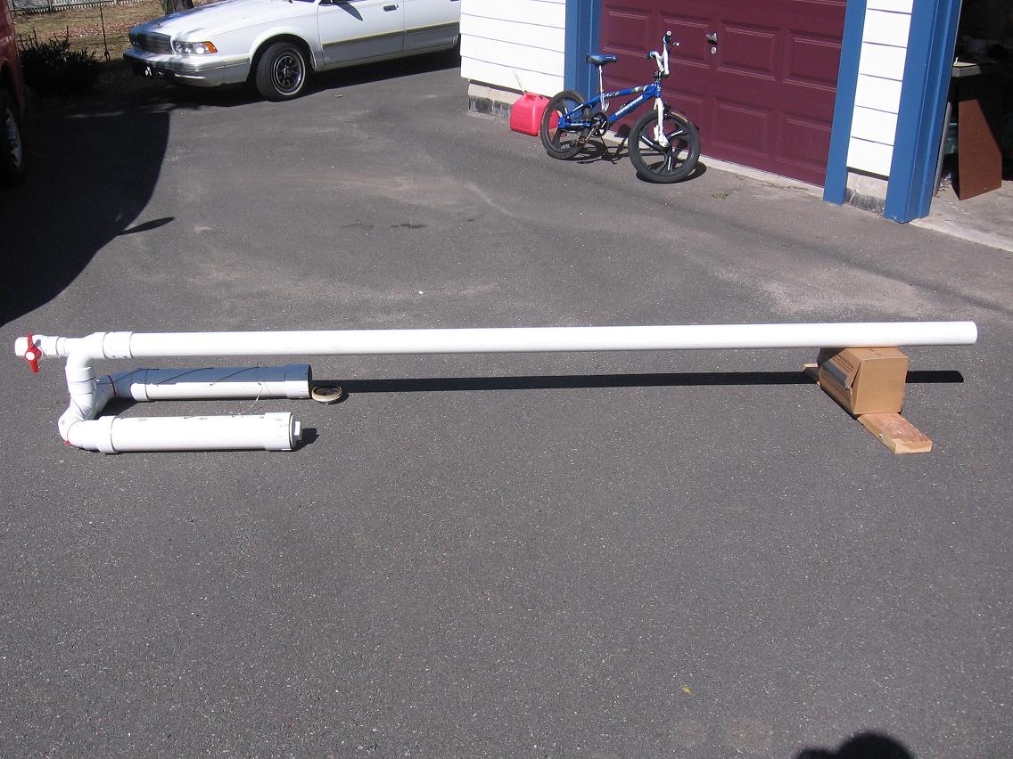

Hehe I'm a new member but would it be too much too ask for some feedback on my cannons? There kind big. "Go big or go home" as they say.
STATISTICS
THE "SARGE"

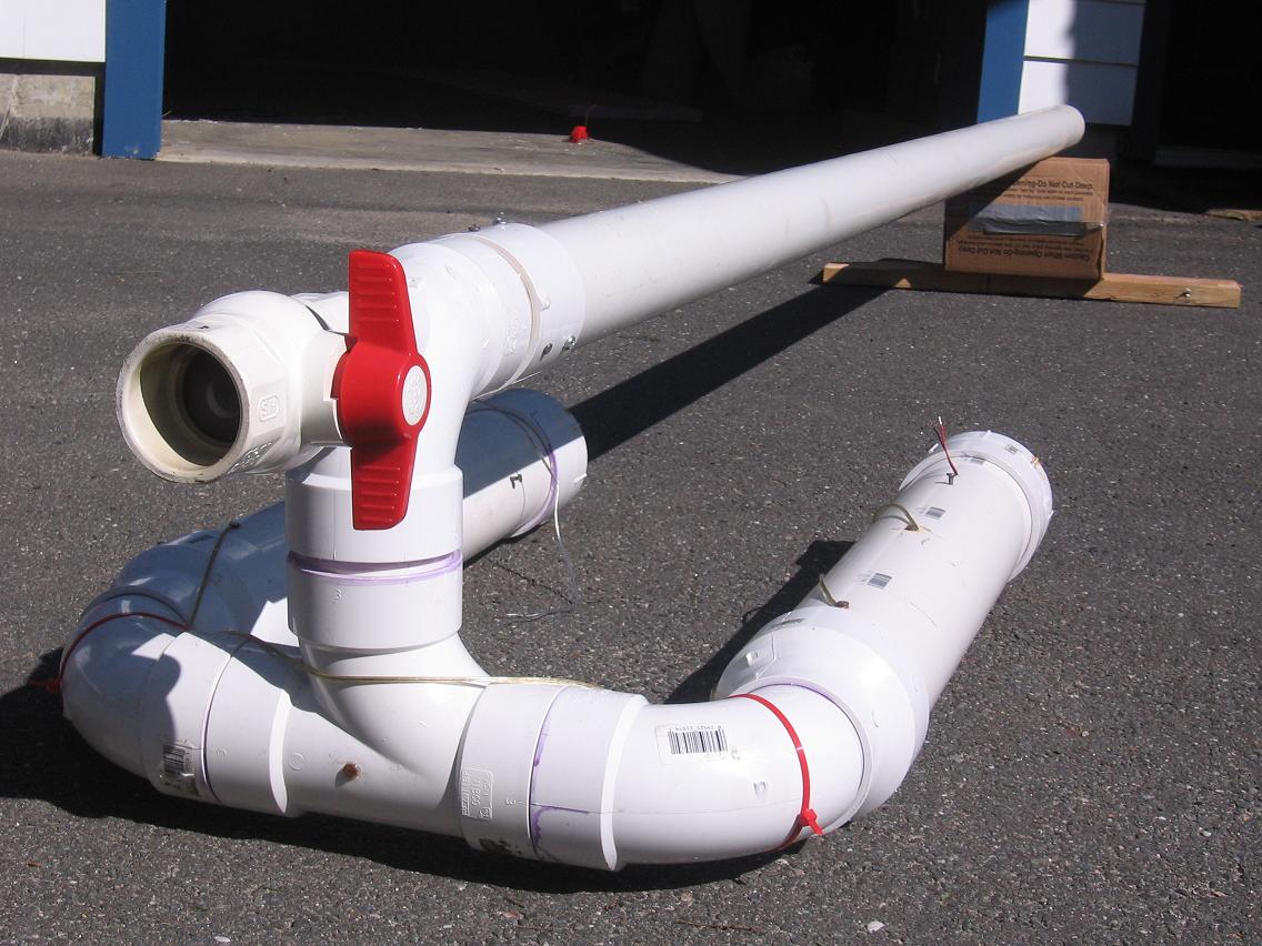

The barrel on the "Sarge" is 1.5 in. in diameter and the length is 5 ft. The chamber on the "Sarge" is 4 in. in diameter and about 4 in. short of 5 ft. in length. I'm thinking about using a dual gap on it in the near future.
THE OLD "GENERAL"

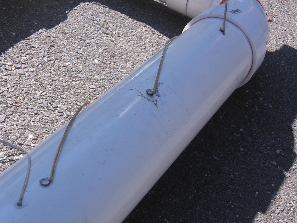

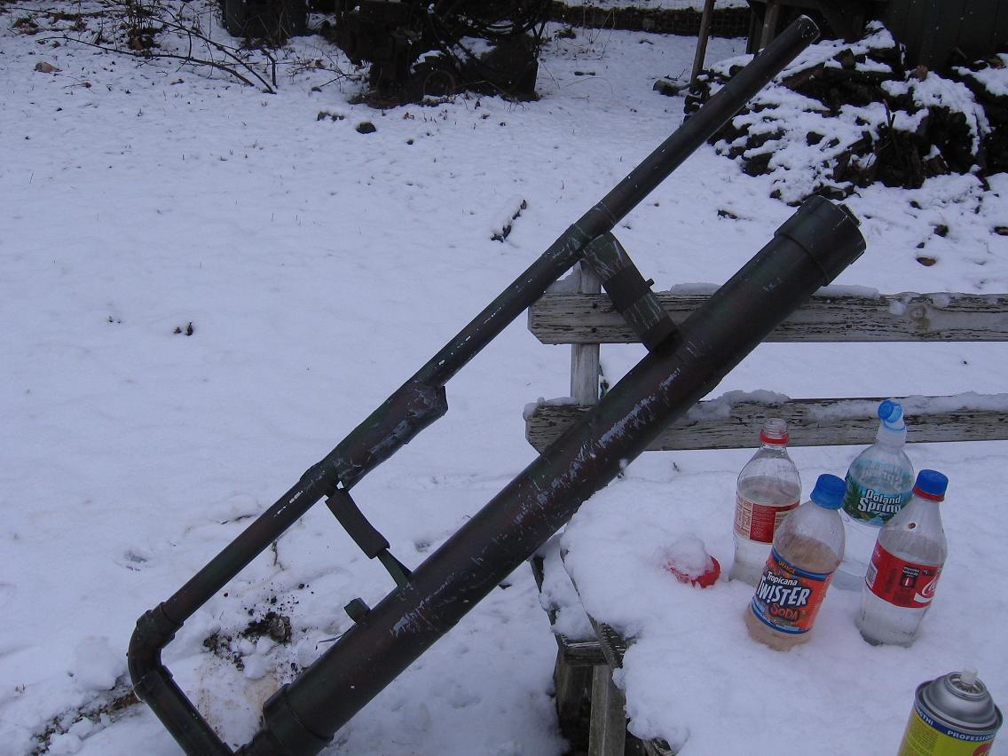

The "General" is a monster with two 4in. chambers at 3 ft in length with a spark gap in each chamber. The barrel on the "General" is a whopping 3 in. in diameter and about 5 ft. in length. The "General" is a variant of the cannon designed for the U.S. Department of Agriculture on Spudtech.com. It Uses a power limiter valve (that i don't often use). There is a 7-8ft distance between the sparker and the cannon itself when firing.
THE NEW "GENERAL"

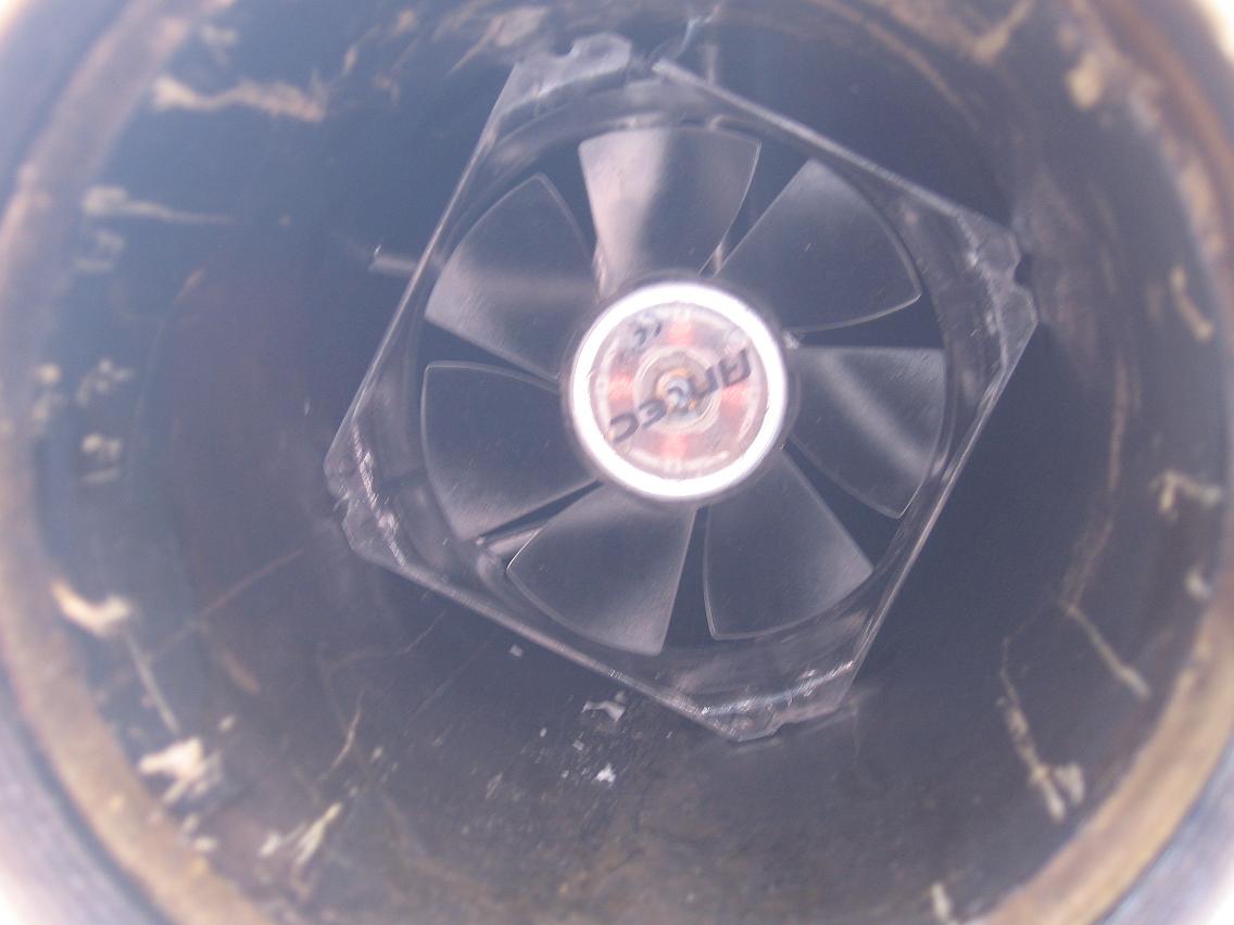

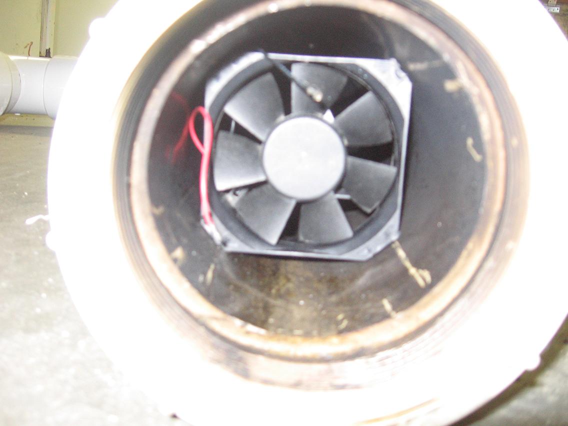

The monster of Connecticut has grown even more! In it's development it has grown a 10ft barrel, 4 new spark gaps for a total of 6, 2 new chamber fans, and an ignition coil firing system.
POWER
The mathematics were done using the video recorded for youtube and it is estimated that the "Sarge" has a muzzle velocity around 250 ft/s and the "General" has a muzzle velocity of 300 ft/s. Yes, the bigger gun that uses heavier ammo is faster than the smaller one.
EDIT: The "General", since it's overhaul, has an estimated muzzle velocity of 350 ft/s.

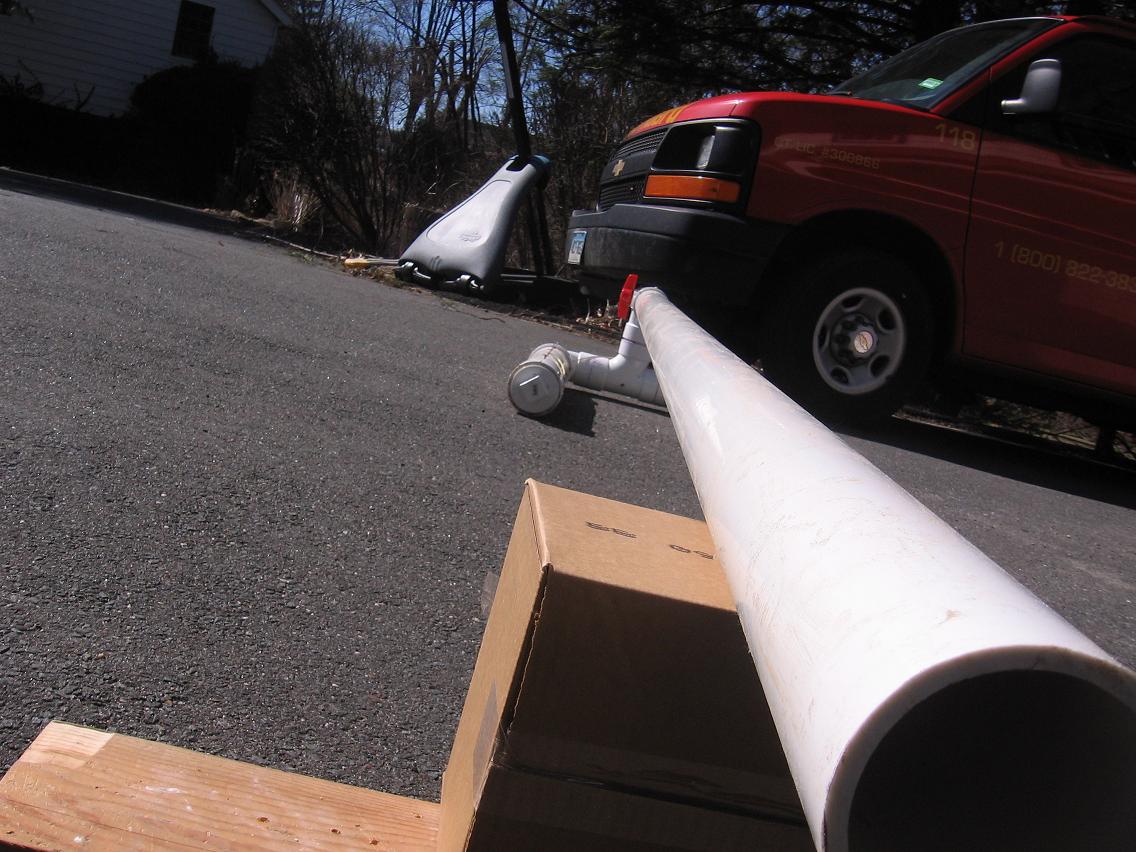

This is a new video that I didn't know was made. Found it the other day on youtube. This one is unedited and brings the image of the gun into viewable perspective.
Monsters of the Potato Gun World (video update 2/3/08)

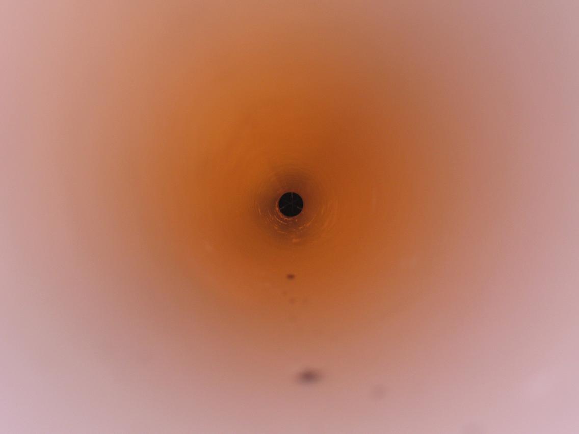

- Looking down the barrel
- Muzzle.jpg (31.65 KiB) Viewed 9142 times

And what's the ball valve on the back of the General for? I wouldn't call these things monsters, as they could easily be handheld. The 3" barrel is a rather uncommon feature on combustions, as it makes finding ammunition a bit more difficult. If you can put enough power behind it however, 3" is actually a very good barrel size.
