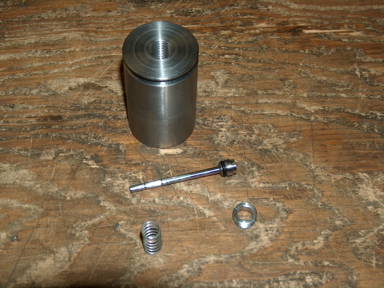

Rear plug w/spring seat, spring and hammer, Hammer valve, piston, ring to be sectioned for centering of barrel, Quad ring
