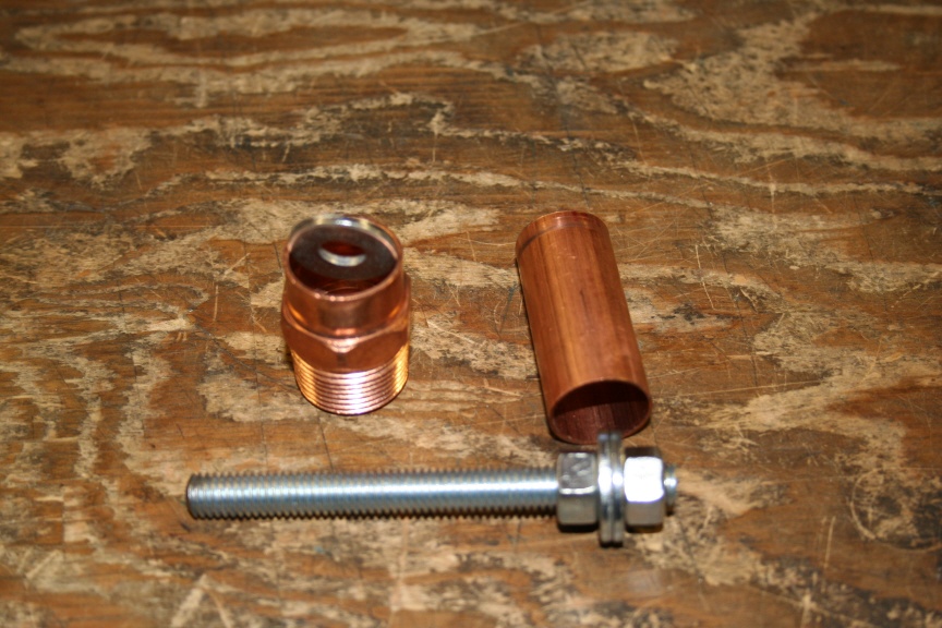

Material list:
3/4" copper tube one 25" piece and one 2" piece I used type M
One 3/4" tube to 3/4"NPT fitting
3/8" all thread rod 3 foot length
3/8" x 2" grade 5 bolt
(6) 3/8" flat washers
(1) 1/2" flat washer
(6) 3/8"nuts
(1) 3/8" threaded coupler (long nut)
(1) 3/8"od. x 1" length compression spring (a light one)
Fibreglass resin or other low viscosity (runny) epoxy
(1) 012 o-ring
(1) 114 o-ring
Red Loctite/5 min epoxy/jb weld/ etc. (any one, I had red loctite)
Tools required:
Drill press or (much more difficult) 3/8" hand drill and a willing friend to hold it
Metal file
Hacksaw
Tubing cutter
Torch, flux and solder or suitable HIGH strength epoxy
Wet/Dry sandpaper ~320 grit
Measuring tape
Marker (sharpie pen)
Update: My pump and check valve have been tested and proven (to my satisfaction) to 400psi.
Let's get started.
Easy stirrup pump
- Gippeto
- First Sergeant 3
- Posts: 2506
- Has thanked: 2 times
- Been thanked: 17 times
- Cut the head off of your 3/8" bolt. Thread a nut on and snug it down. Cut the threaded portion 1/8" out from the nut. Chuck it in the drill press and file the threads until the spring fits slightly loose. Remove from drill press. Place an 012 o-ring and 2 flat washers on the long end. Mark and cut here. Clean up the cut with the file and bevel the edge. File two flat spots on this end. (look at the pictorial if in doubt) Turn off the nut, apply Loctite or epoxy to seal the threads. Spin the nut back on, snug it, and clean off any excess Loctite or epoxy.
