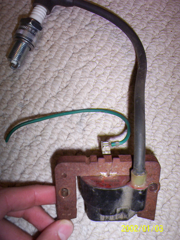

anyway, i stole an ignition coil from my push mower but dont know how to make the connections because it's set up kinda weird. If somebody could edit my pic and tell/show me where i should make the connections in relation to the flash circuit, it would be greatly appreciated.
****! are you sure i cant use this?

Sure you can, just not with the camera flash.
If i understand correctly, it runs off mechanical power.
