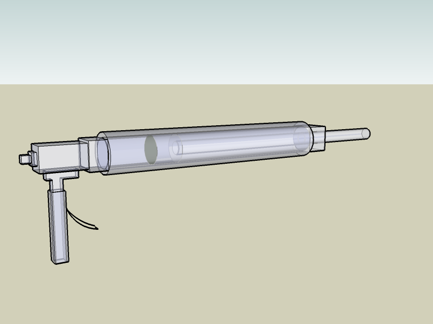

Ok I made a drawing on google sketchup.. it sucks because its the second thing I ever made..but I don't know how to convert SKBs..
Counterstriker
Posts: 426
Joined: Tue May 29, 2007 2:06 pm
Hey! Sorry for the triple post :oops: . It won't let me delete.. (can a mod help me out :) ) But this is my basic design. I am hoping to order the epoxy this weekend, I will see if home depot has it but last time I was there it was all thick junk..

looks good, but is that square in the fount going to be a clean out or something?
Counterstriker
Posts: 426
elitesniper wrote:looks good, but is that square in the fount going to be a clean out or something?
I just put it there to show that there will be some reducers : ) Will they have reducers to.. 8mm or.. 6.. aroung there? Or will I have to make some epoxy casts..

looks quite good so far
Well I prefer the good old marine epoxy but yes there are better things to use.
one thing though.
when i made my coax it wouldnt actuate with just the blowgun normally I had to mod it. But a 1/4in ball valve gives much higher performance than even a modded blowgun.
Its probably already been mentioned but what pressure do you plan on useing?

Well.. I am guessing about.. 200 psi. I am buying a new 2 gallon compressor monday also with the rest of the pieces I need, (shrader, 3/4 reducer, 1/2 bushing and 3/8" pipe). But when you say a ball valve is faster, will the blowgun still be efficeint?

that blow gun is the wrong way, you should swtich it to the 1/4 npt side the other side leaks.

I had a change of plan. The piston will be in the 1/2" nipple (right next to the 1/2 tee). So the problem is the barrel will be long, I already cut it to right size, How can I stabalize a 3/8" barrel in a 3/4" chamber? (this is all steel, the barrel is copper).
