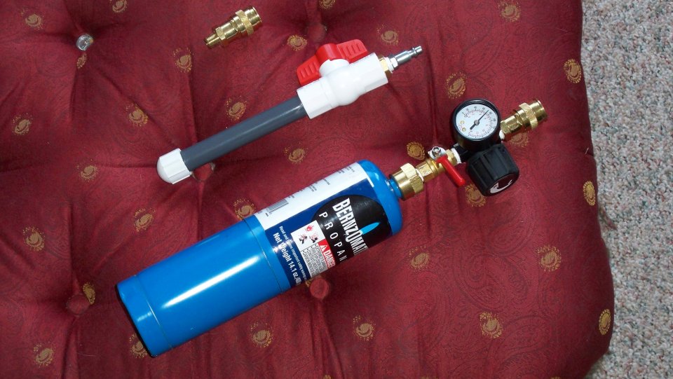

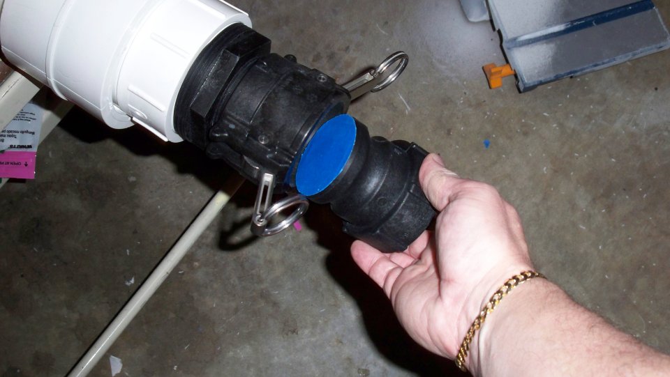

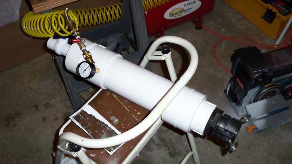

I'm doing the same thing for my Summer gigs. However, I'm building 4 combustion units to attempt to keep up with pace of the 1812. An ear-protected operator with be reloading the quad-battery with pre-measured syringes of propane and pre-built burst disk barrel stumps.
I will be firing remotely in time with the music.
This thing is immensely loud!
The syringe system.

One unit almost ready to go. Need ignition system added.
Burst disk barrel stump.

That unit I show there basically becomes a pneumatic with the back ball valve closed and burst disk installed. That's how I've done most of my disk testing. I wear ear protection when shooting it pneumatically...it's way loud. It just misses having the same reverberating boom as it has during a combustion blast.
I have used only 80 psi disks however...the most I dare do with a 1x combustion. A higher psi disk would I'm sure have a somewhat louder report on a pneumatic, just not sure it would have the boom I want.
