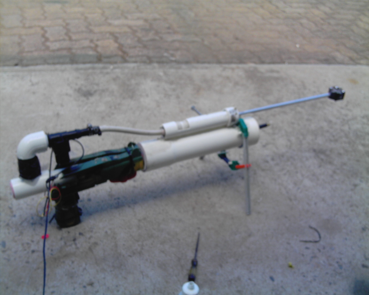

Pre- charged Pneumatic bolt action bb rifle
this is my bb rifle, i have tested it and its around the 300-600 fps range. The last shot i did was at 120psi with a perfect sizes pea.
took a while to make. Click here for more pics
ill have video of it shooting later on today.
so far ive tested it and the most power ful shots and the first 2, the rest are little bit less.
atm the solenoid is opened using a power pack but in the next couple of days i intend on getting a couple of 12v batterys and doing the whole wiring up thing.
comments please, constructive criticism is very helpful

Wow thats sweeeeeeeet, I like the bipod.
... Cant wait for the vid!!!
How big is the chamber?

main chamber is 1' of 50mm and the secondary firing chamber is 600mm of 25mm
- XxtriviumxX
- Posts: 173
- Joined: Wed Apr 18, 2007 9:54 pm
- Location: Australia
Oh ok... When I first saw it I got the impression that it was much bigger.
like 2' or something around that... Now when I look at the schrader valve in comparison to the end cap i can see how big it would be.

I think you did a fine job!
You used available materials and creativity to build something far from average.
I'll give you the big TWO THUMBS UP!

2" is 50mm, so it is what you thought.XxtriviumxX wrote:Oh ok... When I first saw it I got the impression that it was much bigger.like 2' or something around that... Now when I look at the schrader valve in comparison to the end cap i can see how big it would be.

isnt inches this " and ' feet ??

nice
if you practice fast loading it's so cool
but replace the knexx thingy
and use wood or metal
I like video's
can you post some pics from a shot on an empty can ?
I like video's

it looks a bit ghetto but I like the fact that you built something creative...

Holy C:B ratio batman!
Good job. Clean it up a bit and give it a paintjob.
good job, really nice gun and creativeness. yes " is inches and ' is feet.
no carlman i was talking to the other guy.ajdevi92 wrote:isnt inches this " and ' feet ??

My only complaint is that you have a big heavy hunk of metal on the end of the barrel that serves no purpose other than to bend your barrel out of shape. Also, WTF is up with that C:B ratio? do you have another valve somewhere that I cant see?
