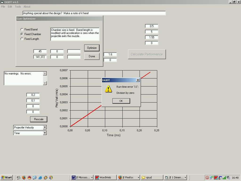

POLAND_SPUD wrote:It sometimes crashes when I use gun optimization tool and "division by zero error' ocures but I've noticed it happends only when I use metric units....
Again, there's that word... "sometimes." I need a specific example before I can do anything about it.

first of all I currently use ggdt 4.5 but I had the same problem with 4.4
GGDT crashes when I tick 'fixed chamber' in gun uptimizer tool and I click 'optimize' button... instantly a message "run time error '11' division by zero" occures
It happends only when I use metric units (I've converted the same design to imperial units and used the same fuction and everything was ok)

Does this happen for ANY gun (or is my next move to ask you for a screen capture of the gun that causes this to happen?)?

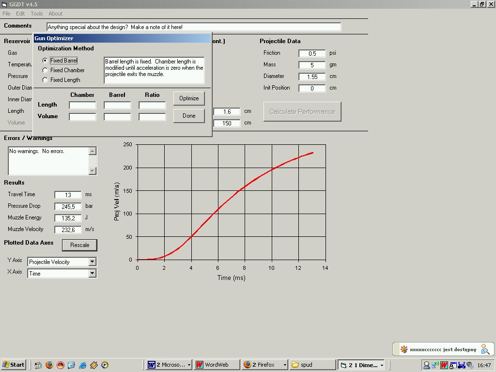

yes it does happen for every gun - however when projectile initial position is "0" it crashes displaying "run time error '11' division by zero"
when there is any value other than '0' in that field it crashes displaying a message 'runtime error '1117' Index given is out of its bands'

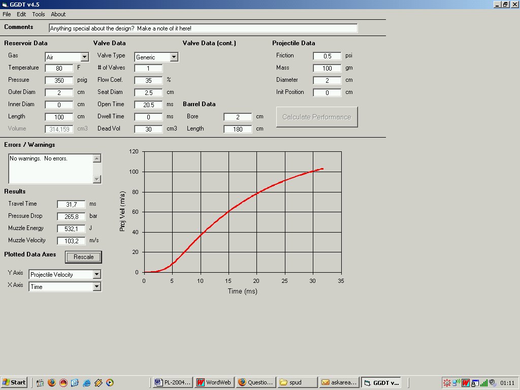

here is a pic if you think it has anything to do with values inserted (this design crashed when I tried using gun optimizer; just like any other design :) )
try doing the same thing yourself you should get the same results

OK.... I misread your original post. When you said "fixed chamber" I read "fixed barrel."
With fixed chamber, yes, I see the crash too. Very interesting.....

GOT IT!
OMG... If the bug was the proverbial snake it would have bitten me half a dozen times. You too!
The problem was actually not in the optimzation routine, it was in the plotting routine. To convert from meters to centimeters I was dividing by 100 rather than multiplying (doh!). While all this would do to the plotting routine was create (for those who were looking closely!) an odd looking X-axis, it would throw the optimize routine for a loop as that routine uses data stored in the plots.
