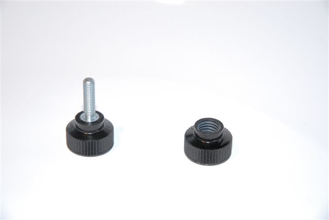

I made the piston out of a knob like this. It is made of very hard (and a little brittle) heat resistant plastic.

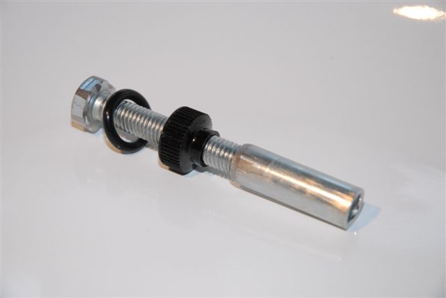

Piston almost-exploded, with a bushing that could just be hammered into the piston tube.

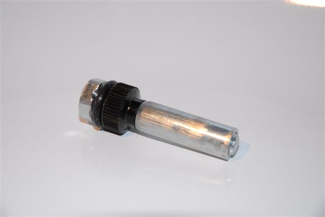

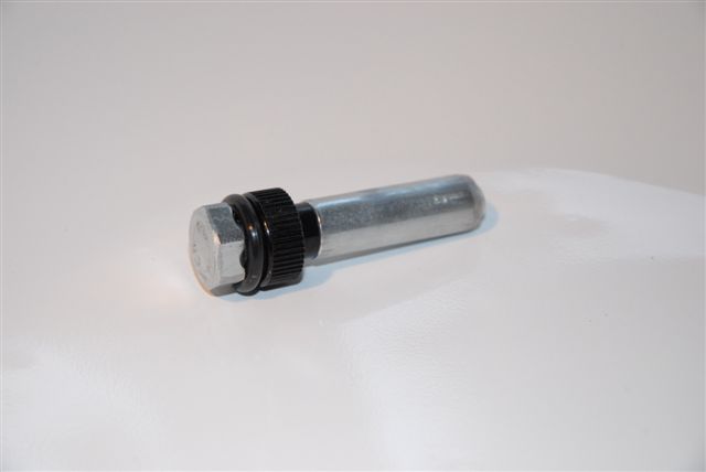

Piston ready to go. I dremelled a few grooves in the bolt to make it leakier on the return stroke.

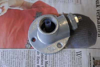

Check valve exploded. The 1/8" elbow just can squeeze into the PVC pipe which is siliconed into the reducers. No epoxy got in...

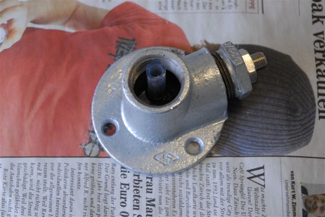

Base with check valve installed, ready for epoxy pouring.

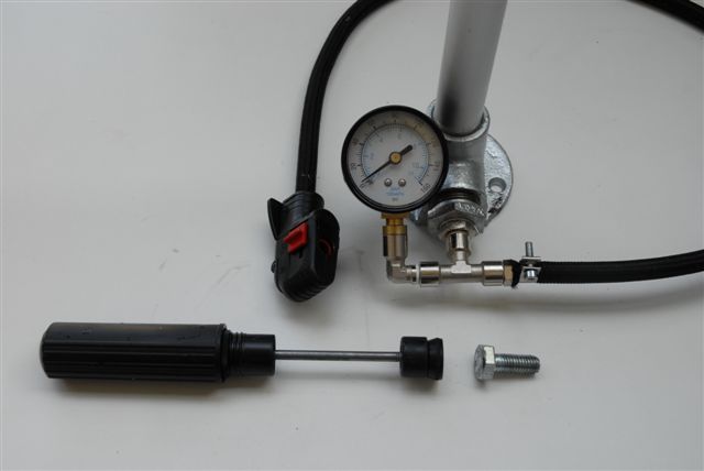

The base, with pressure gauge. The black thing is the piston from a pocket bicycle pump. That fits perfectly, too. It just needs to be cut off, and a 4 mm hole be drilled through the bolt.

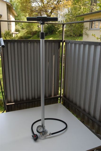

In all its glory. The handle is just 25 mm PVC.
