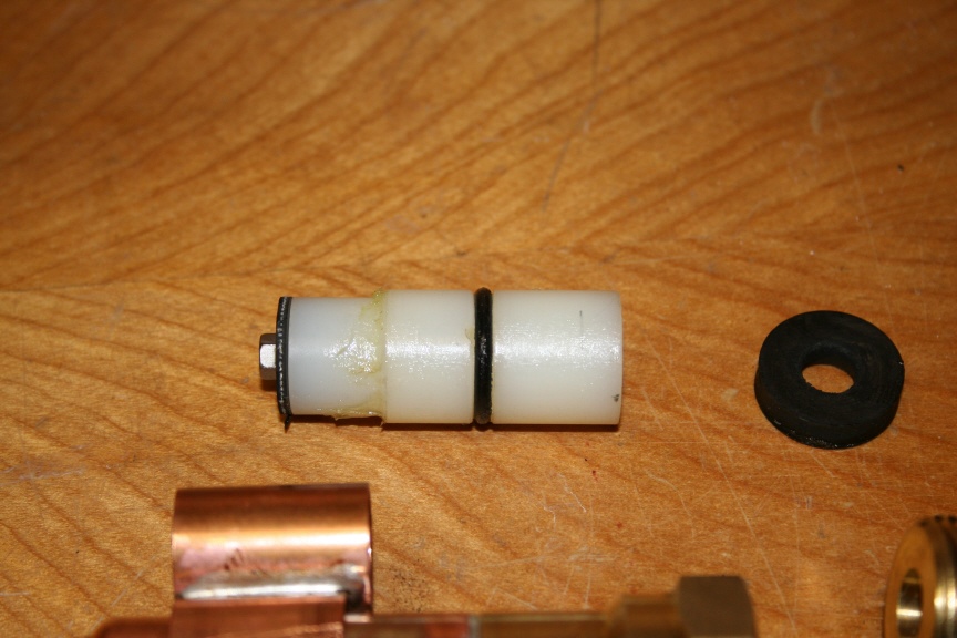

Your equilization hole can be small and does not have to be under the sealing face. If the hole is small, the stored air will take the path of least resistance 1st (out the barrel). If the hole is small 1/16th, not enough air from storage will escape back through it to make a difference.

So I could really put the hole somewhere else on the piston like on the cap? That makes sense that the air would go through the barrel, since after all that has the least path of resistance, just like jrrdw said.
I'll try it on the washer first, and if that doesn't work I'll try the cap, and if for some reason they both don't work, I've got a check coming from Mcmaster.

I think psyix has the right idea as far as increasing frontal area is concerned.
Your new piston looks promising, if I might offer a suggestion though;
If you make the o-ring grooves a little "sloppy", (deeper and wider) and then drill a hole half into the o-ring groove (on the chamber side), it'll work for equalization, and double as a check valve.
(simple floating o-ring)
I did this with the piston on my copper gun, it works very well.
I'll put up a pic, look close, the hole looks almost like a "chip" in the groove.

Thanks alot Gippeto, I think that's the way I'm going to do it. I'm definitely going to need a check valve in this piston, I just got the o-rings today and it is a very tight fit.Gippeto wrote:If you make the o-ring grooves a little "sloppy", (deeper and wider) and then drill a hole half into the o-ring groove (on the chamber side), it'll work for equalization, and double as a check valve.
It took less than 30 hours to ship from McMaster.
I agree, there appears to be too much piston clearance. That thing should be so tight you need to really shove it in there. Also, I think you might be jamming due to the weight of the iron pipe cap in front. As the piston disengages, it will force the front end down and the back up making it jam. See if you can't replace the cap with a 1/4 in. bolt, washer and nut, for plenty of holding power and much less weight. I've had similar problems with piston valves in the past.
