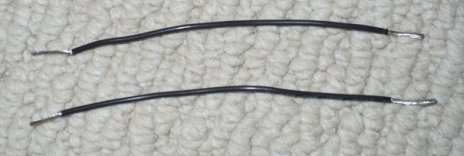

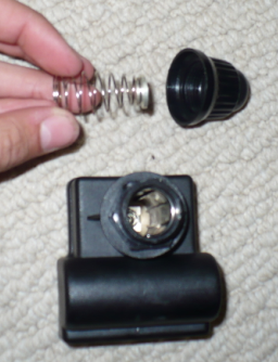

Hello fellow spudders! I recently bought an electric BBQ igniter from Walmart for $15.00 USD for one of my many projects, and figured out a way to easily modify it for a momentary switch or toggle switch so the unit itself can be contained in a circuit box, with the leads of the switch going to wherever on the gun you want for comfortability when you shoot and so your trigger can be wired in a handle.
I thought, what the hell, I haven't seen anything like this on spudfiles, so why not make a "How-To" on how to do it. I'm sure there are members who would like to know themselves...

Nice job STHORNE. I never would have thought of leaving the battery in place. Usually, people would bring the battery contacts out of the case to another battery holder + switch setup. Amazing that you can fit the needed wires in the battery holder with the battery in place.
What kind of spark do you get with that particular sparker? Better, worse, about the same as a BBQ piezo? What do you estimate the maximum gap is?
BTW, trying to take the sparker apart might not be a good idea. Besides being a fused case it may well be pretty much completely filled with potting compound. Removing (and probably destroying) the case might not accomplish much. Besides, looking at the case, I bet there isn't a heck of a lot of emtpy space inside, so it might be pretty tough to get it into a smaller case.
You can set it up for two spark gaps using just it's three output wires. Each being about 2-3cm wide. Or you can wire more spark gaps with smaller sparks. one spark from the electric BBQ have the same results as a basic piezo accept you can have more than one spark gap of the same size and it won't wear out on you...you would just need to change the batteries from time to time.
