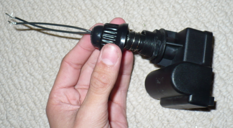

MODIFYING AN ELECTRIC BBQ IGNITOR
Hello fellow spudders! I recently bought an electric BBQ igniter from Walmart for $15.00 USD for one of my many projects, and figured out a way to easily modify it for a momentary switch or toggle switch so the unit itself can be contained in a circuit box, with the leads of the switch going to wherever on the gun you want for comfortability when you shoot and so your trigger can be wired in a handle.
I thought, what the hell, I haven't seen anything like this on spudfiles, so why not make a "How-To" on how to do it. I'm sure there are members who would like to know themselves...
I would have originally bought a stun gun, but being in Wisconsin, laws make it hard for me to get my hands on one and the BBQ Igniter wasn't too bad of a price, so I bought it instead.
Well, Tell me what you guys think and Happy Spudding!
STHORNE

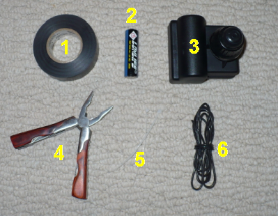

Here are the supplies you will need:<br />1.Electrical Tape<br />2.AA Battery (should come with igniter)<br />3.The BBQ Igniter<br />4.Leatherman/All-purpose Pliers <br />5.Some Zip-Ties (optional)<br />6.Wire (semi-heavy guage)
1.Electrical Tape
3.The BBQ Igniter

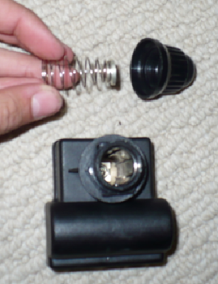

First, take apart the Igniter by unscrewing the button/cap and pulling the spring from the button.  It pops right back in so don't worry about pulling it out.

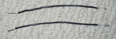

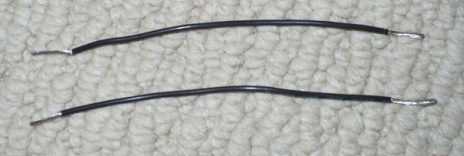

Cut two sections of wire about 4-5&amp;quot; long and strip 1/2&amp;quot; from the edge on each end.
Cut two sections of wire about 4-5&quot; long and strip 1/2&quot; from the edge on each end.

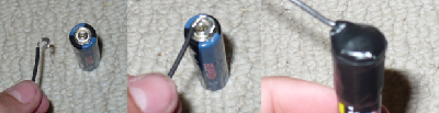

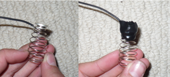

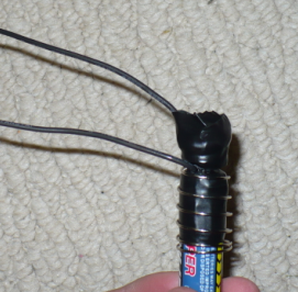

Wedge the end of one of the wires between the aluminum disk at the top and the part of the spring that wraps around it and secure with electrical tape.  Don't use too much tape though...

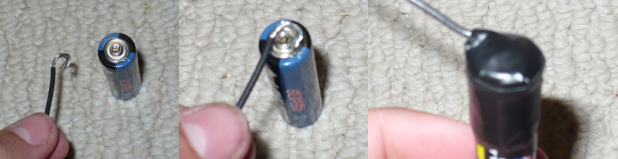

Bend the end of the other wire into a &amp;quot;U&amp;quot;-shape so it fits around the small part on the positive end, then secure it with electrical tape.  Again, don't use too much tape....
Bend the end of the other wire into a &quot;U&quot;-shape so it fits around the small part on the positive end, then secure it with electrical tape. Again, don't use too much tape....

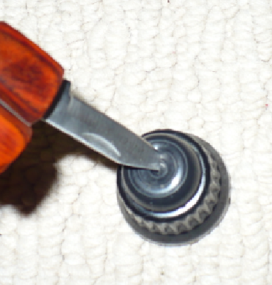

Now use a knife or sharp tool to make a hole in the top/middle of the rubber button.  No more than a few cm wide should be perfect.

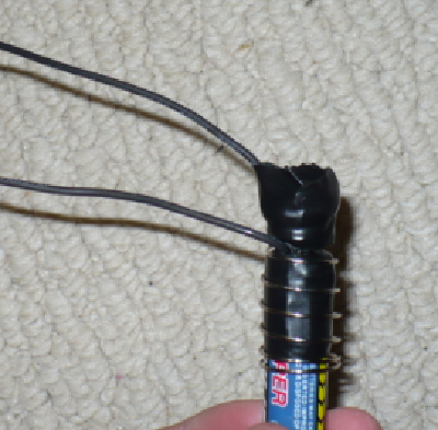

Work the battery inside the spring as far as you can towards the top until it is snug.

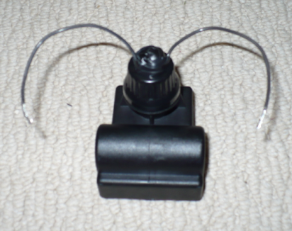

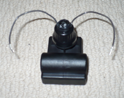

Now string the wires through the hole in the rubber button and screw the assembly back together.  It may be a tight fit but the tighter, the better because that's less of a chance of any of your connections coming loose.  You can zip tie the wires together to keep them from moving if desired.
Congratulations!!!  Now all you have to do is connect the two lead wires to your desired trigger and your done!

Nice job STHORNE. I never would have thought of leaving the battery in place. Usually, people would bring the battery contacts out of the case to another battery holder + switch setup. Amazing that you can fit the needed wires in the battery holder with the battery in place.
What kind of spark do you get with that particular sparker? Better, worse, about the same as a BBQ piezo? What do you estimate the maximum gap is?
BTW, trying to take the sparker apart might not be a good idea. Besides being a fused case it may well be pretty much completely filled with potting compound. Removing (and probably destroying) the case might not accomplish much. Besides, looking at the case, I bet there isn't a heck of a lot of emtpy space inside, so it might be pretty tough to get it into a smaller case.

You can set it up for two spark gaps using just it's three output wires. Each being about 2-3cm wide. Or you can wire more spark gaps with smaller sparks. one spark from the electric BBQ have the same results as a basic piezo accept you can have more than one spark gap of the same size and it won't wear out on you...you would just need to change the batteries from time to time.

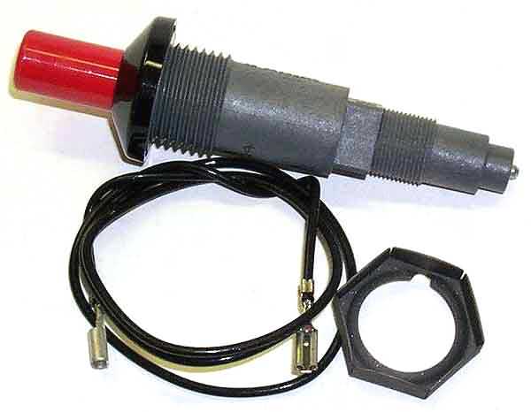

My question is that why wouldnt you just buy a BBQ ignitor like this one
Its only 10$ at walmart and im pretty sure you can find it at Ace also.
Im not trashing this thread or anything. Im just sayin, why spend 20$ on something that you have to put time into when you can spend 10$ and have it done for you.
Good info BTW

daxspudder wrote:Very nice, I think I will buy one of these and take it apart further to see if it can be modded even more, that way you can lose the bulky casing, and make it easy hidden/stored in a handle or recess... Thank you again.
If you are concerned about size you may be better off getting one like this.
http://cgi.ebay.com/MHP-Gas-Grill-Elect ... 0238615318
It only has a case around the circuit board and that battery compartment/button could be hacked off pretty easily. It is about 2.25" x 1.5"

pvcpsyco wrote:My question is that why wouldnt you just buy a BBQ ignitor like this one

lol, nope. Thought about this myself a few hours yesterday and it just seemed like the best solution to me. Easy and reliable. And thanks for the link to the laser mod on Burnt Latke, I have had some similar ideas but never got around to doing it.
